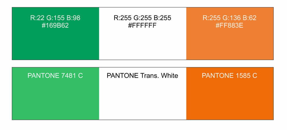

shoresigns
You picked a very reddish orange, compared to the actual orange in the flag of Ireland. Put that colour side by side with [HASHTAG]#FF883E[/HASHTAG] to see the difference. The official colours are in the Wikipedia article:
https://en.wikipedia.org/wiki/Flag_of_Ireland
And next time, ask the printer what colour mode will give you the best accuracy. Most large format printing is done in CMYK, but different shops will have different preferences and ways of dealing with RGB, CMYK or Pantone artwork.
