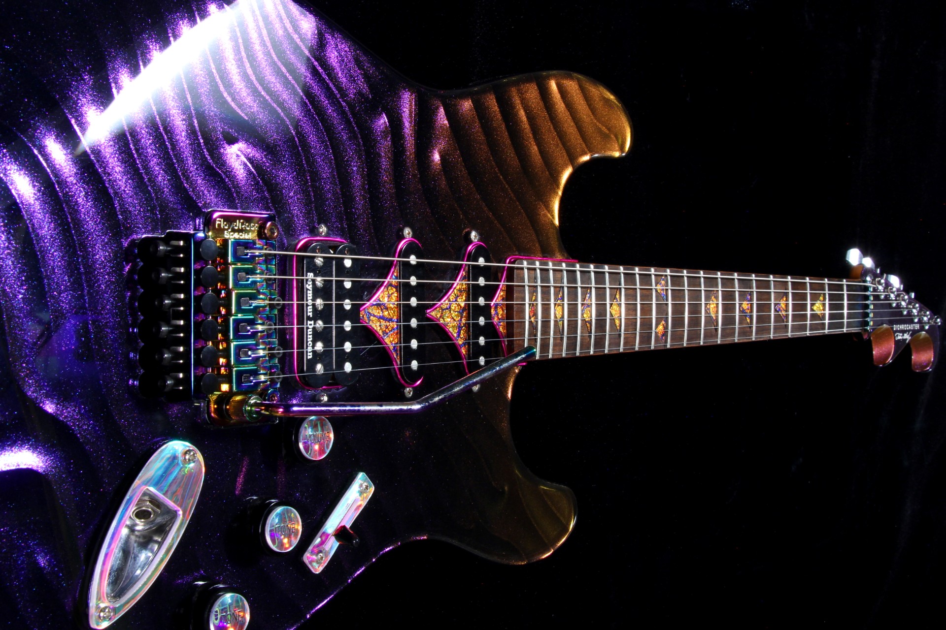

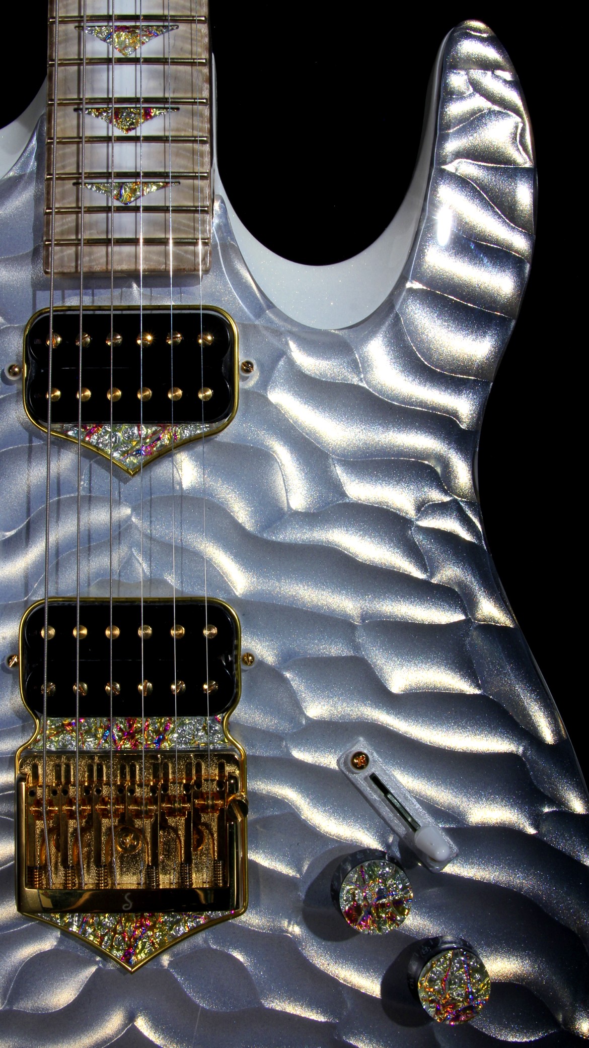

    I've had success adding methylene chloride to Bulldog plastic primer and also thinning down 2 part acrylic cement with MC into sprayable viscosity as a bonding primer for acrylic. Welds itself to the plastic, then topcoat with solvent based coating while tacky. My best coatings are thinning 2 part acrylic cement, thinning with MC, then adding my own powdered pigments (solid black or white following pearl coats) and spraying effects pigments for a direct weld to acrylic like this guitar that I back coated with Silver Borosilicate backed in White. I did the same with color-shifting pigments in the purple guitar. QuiltSilver-Boro-Burl-Clsp-right.JPG Dcstr-Studio-skew-1920.JPG
