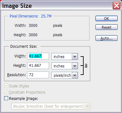

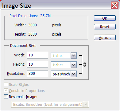

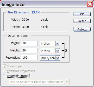

When dealing with image sizes, the only thing that matters is pixel dimensions. That shows you the actual size of the image so you can evaluate its suitability for your project. Resolution, DPI etc. only come into play when you hit the Print button.
In the following examples, it should be clear how these things can be evaluated. I have created an image in Photoshop that has pixel dimensions of 3,000 x 3,000. If I click on the Image menu > Image Size, the dialog shows me the various numbers. If I uncheck the "Resample Image" check box, I see that the size is 41.667" x 41.667" at a resolution of 72 pixels per inch. If I change the Resolution setting to 100, then the size will be 30" x 30". And if I change the Resolution to 300 PPI, the size drops to 10" x 10".
These changes do not represent any change to the actual image because Resample is unchecked. They simply show you what you have to work with. When you turn resampling back on, any change you make will result in a physical upsizing or downsizing to the image which is where pixelation and other distortions will happen. So if the actual print size needed is 30" x 30", I know that I can print it at a resolution of 100 PPI without resizing it. But if I need to print it at 300 PPI and at 24" x 24", then I will need to enlarge it to 240% of its original size unless my experience tells me that the RIP software and other print settings will produce a satisfactory print without modifying the original image.
Digital imaging, editing, processing and printing is a science ... but it is also an art and a craft. You'll get better with time, practice, experimentation and experience.
