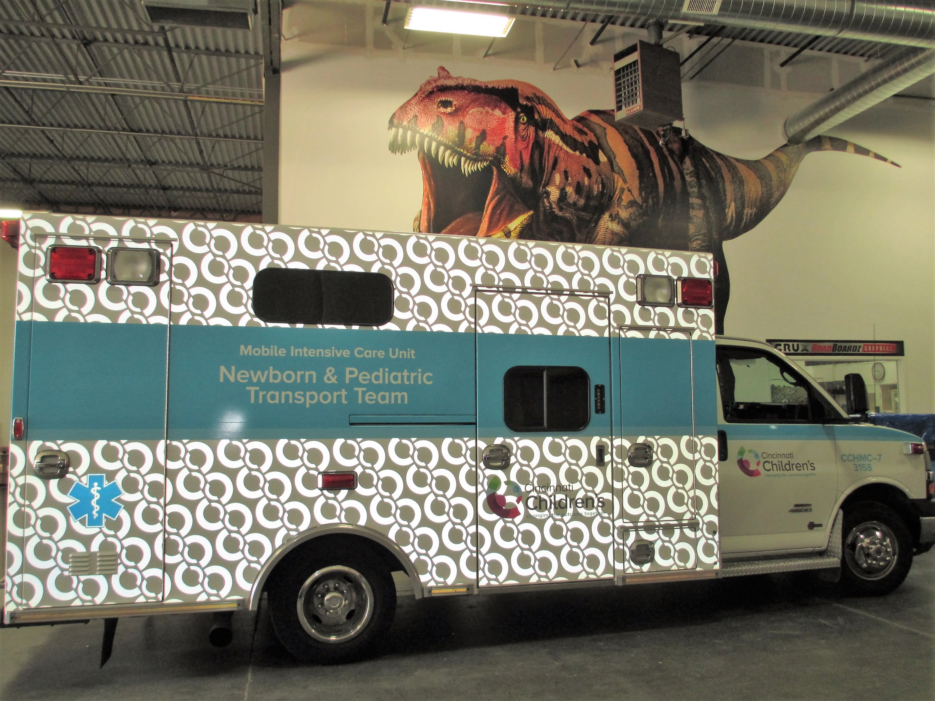

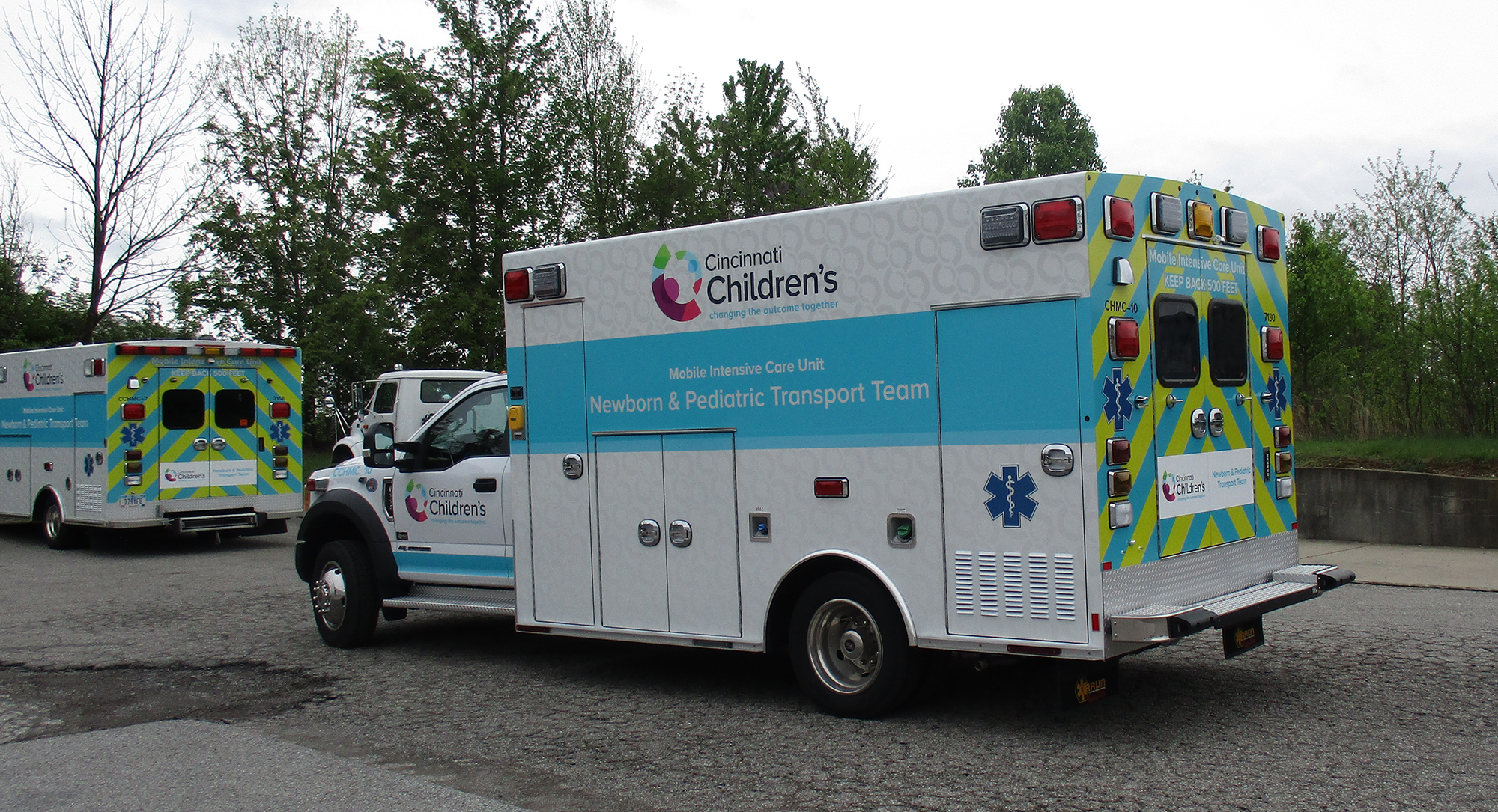

    What about using black reflective and printing black on that. Flood everything with black except for the logo and then laminate with black.
    We did white reflective this way (white ink) and it turned out really cool.

    Oh yeah, on IJ680CR no less. Not an inexpensive wrap.

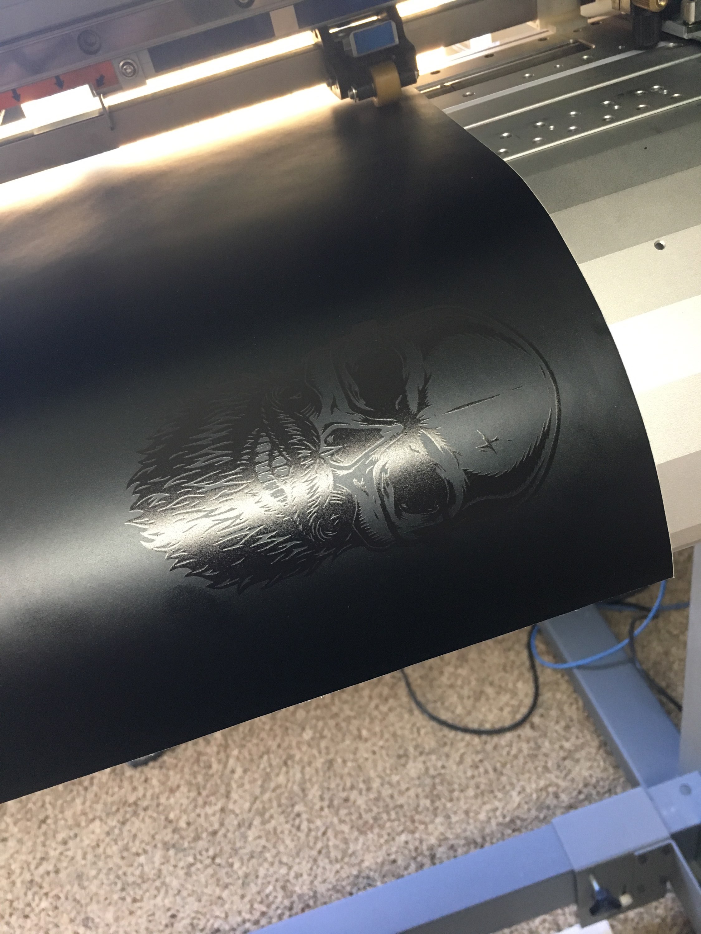

    This is kind of what i am planning but making a pattern. He doesnt want reflective kind of wants it to be just barley showing.

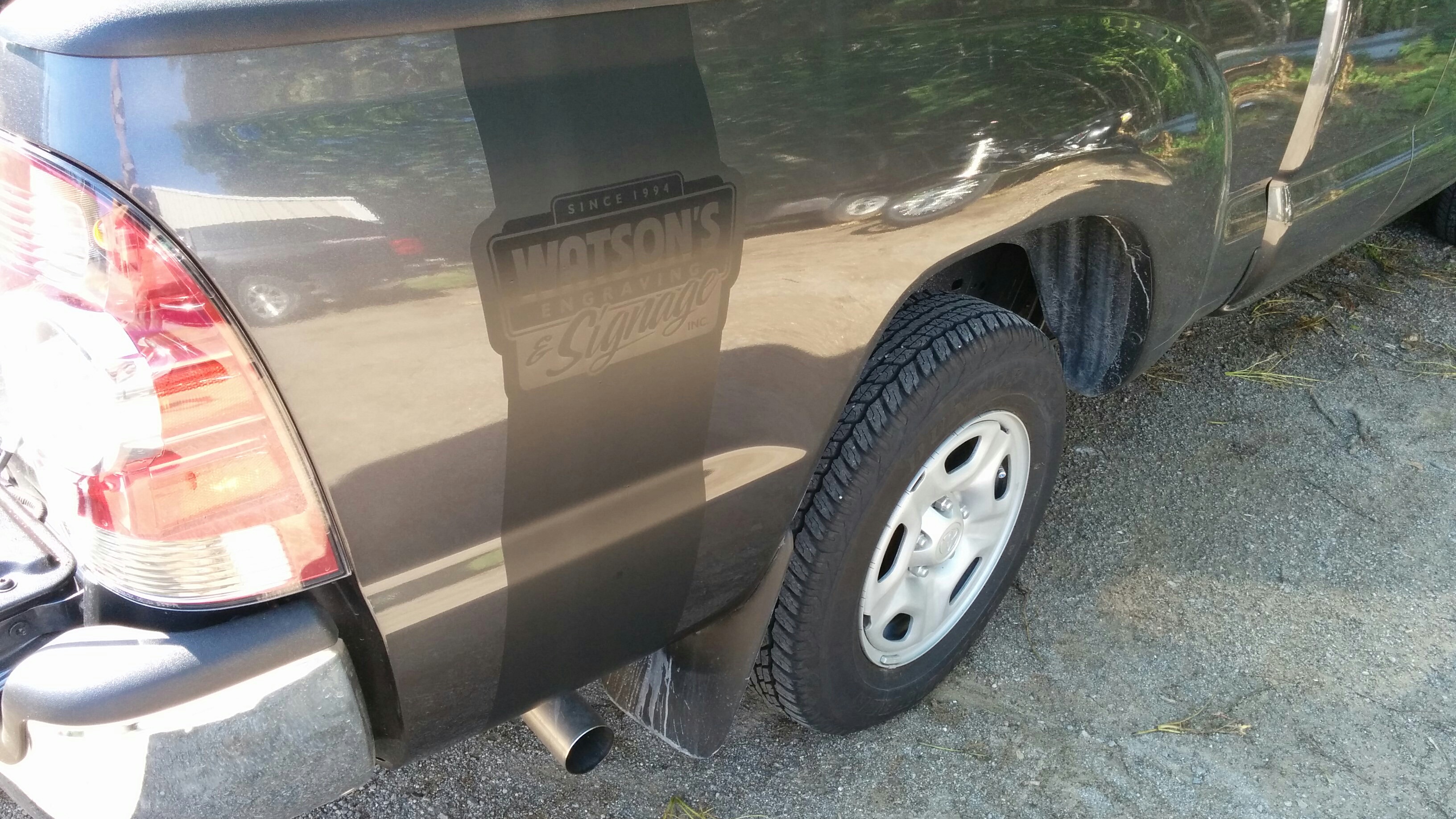

    we printed this on our gerber edge, gloss clear coat foil on matte black vinyl, came out well, it's very subdued until the light hits it at the right angle than it jumps out at you, been on my truck 3 years no and it's still looks great!

  18. jfiscus
    jfiscus Adobe Shinobi
    2,943
    155
    63
    Apr 2, 2009
    Cincinnati, OH
    Not exactly night, but in the install garage with a few lights off.
