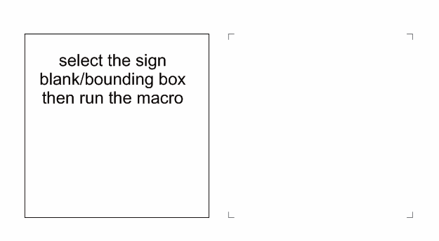

Instead of a bounding box I use crop marks set at 70% black. I use a macro to make 'em.
