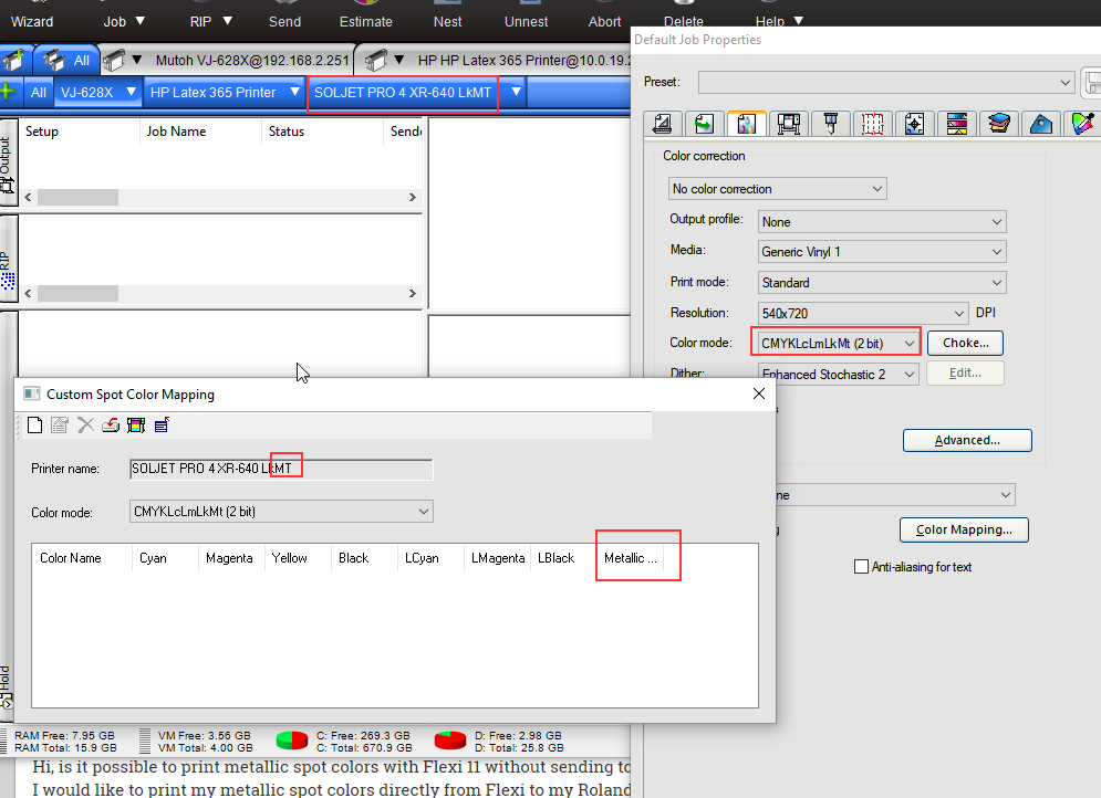

What model of printer do you have and what is set up in Flexi? If you have a model that Flexi supports metallic ink printing and you choose a color mode that includes metallic ink, then your customer spot color mapping is probably the best way to go. You could check the values that Roland gives for the colors that you like and set up your metallic spot colors this way:

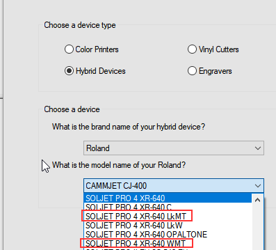

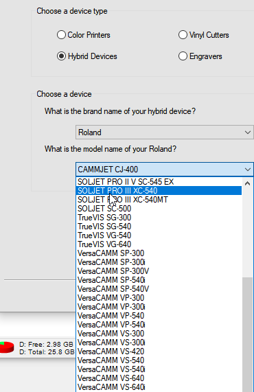

It appears the Flexi doesn't support the Metallic ink mode on that printer:
As opposed to the XR, which has the option:
And this is with the latest version of Flexi, so you won't find it in an older version. So, for metallics, you're stuck using VersaWorks.
