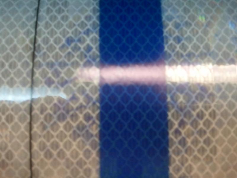

2011-09-27 08.53.24.jpg Im having a problem with this occuring when i print on it. It looks like the color is running on the sides.
Also I am having a problem with two exact same sized signs printing next to each other and one coming out 1/8" smaller than the other.

Not really sure. I'd definitley make sure the head is set to thick(high) and probably run a quick dot position correct. Then start experimenting with temperatures and maybe a couple different profiles. I see the blue off to the sides but I'm unsure what might be causing that. I've printed on diamond grade reflective in the past on our old JV3 but I've not yet had a need to try it on our JV33 yet.
Not sure, but that looks like static is pulling some of your over-spray out a little.
Also, the amount of reflective still visible under the blue looks like when lights are on it at night, there won't be any..... or very little difference from background to copy. These will be more like signs by day and reflective blotches at night.
Screen printing inks are far more opaque and might be the only way to do these. Our flatbed prints far heavier and opaque than our Roland and it does a decent job on that level of reflective. Regular reflective is no problem for either printer.

I have ran this material using true solvent inks on my xljet. Static was always a huge problem. We tried static tinsel, dryer sheets, everything we could think of. The static would build up so much that it would actually pull a perfect little jet patter off the heads every once in a while. Fortunately, it was usually in a white area and could be cleaned with a bit of solvent.
I have tried the same material in my epsons an have had even less luck. I think it takes a really aggressive ink to adhere to this material. Your best bet is to print on clear, laminate and mount I think.
