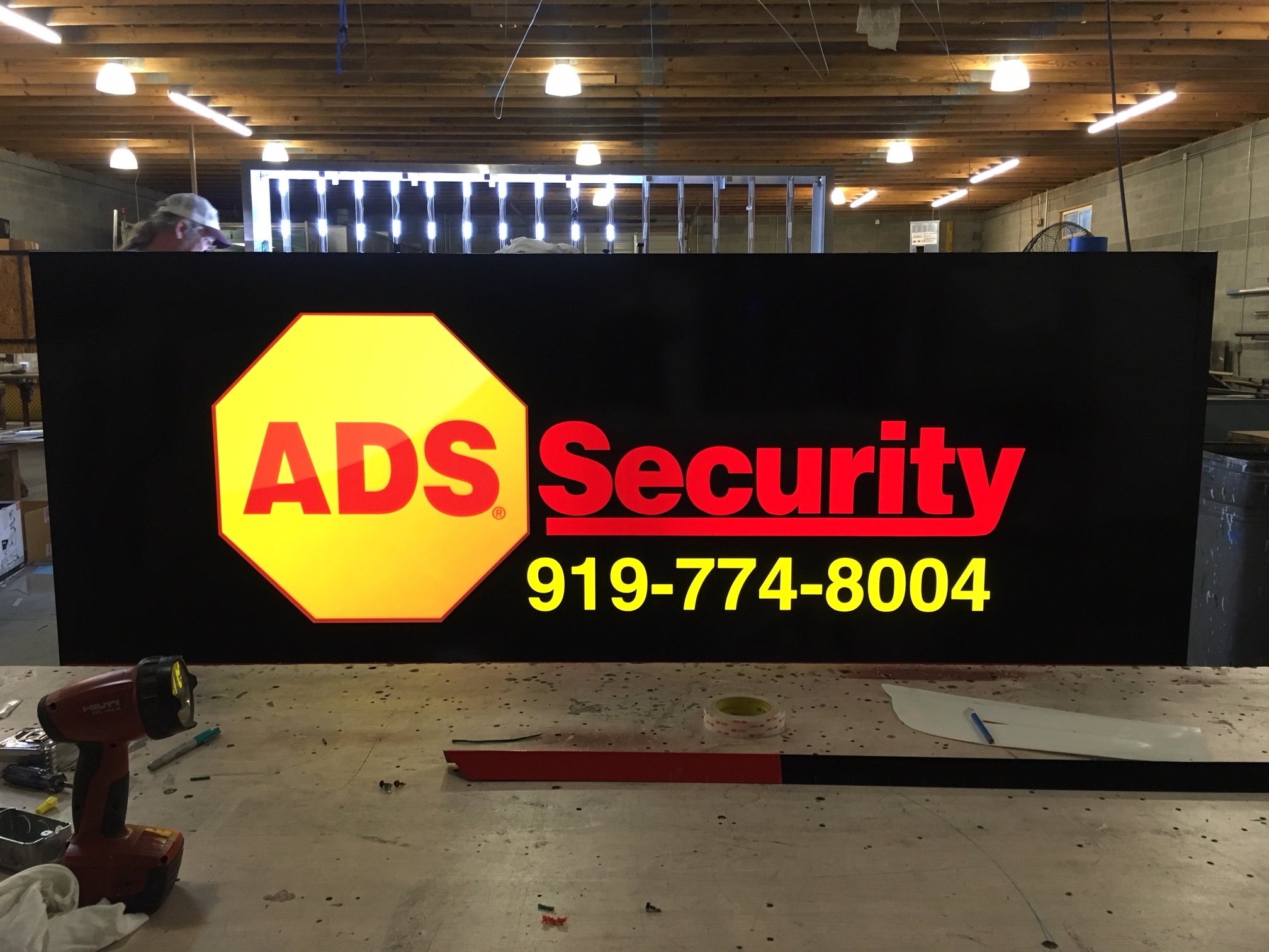

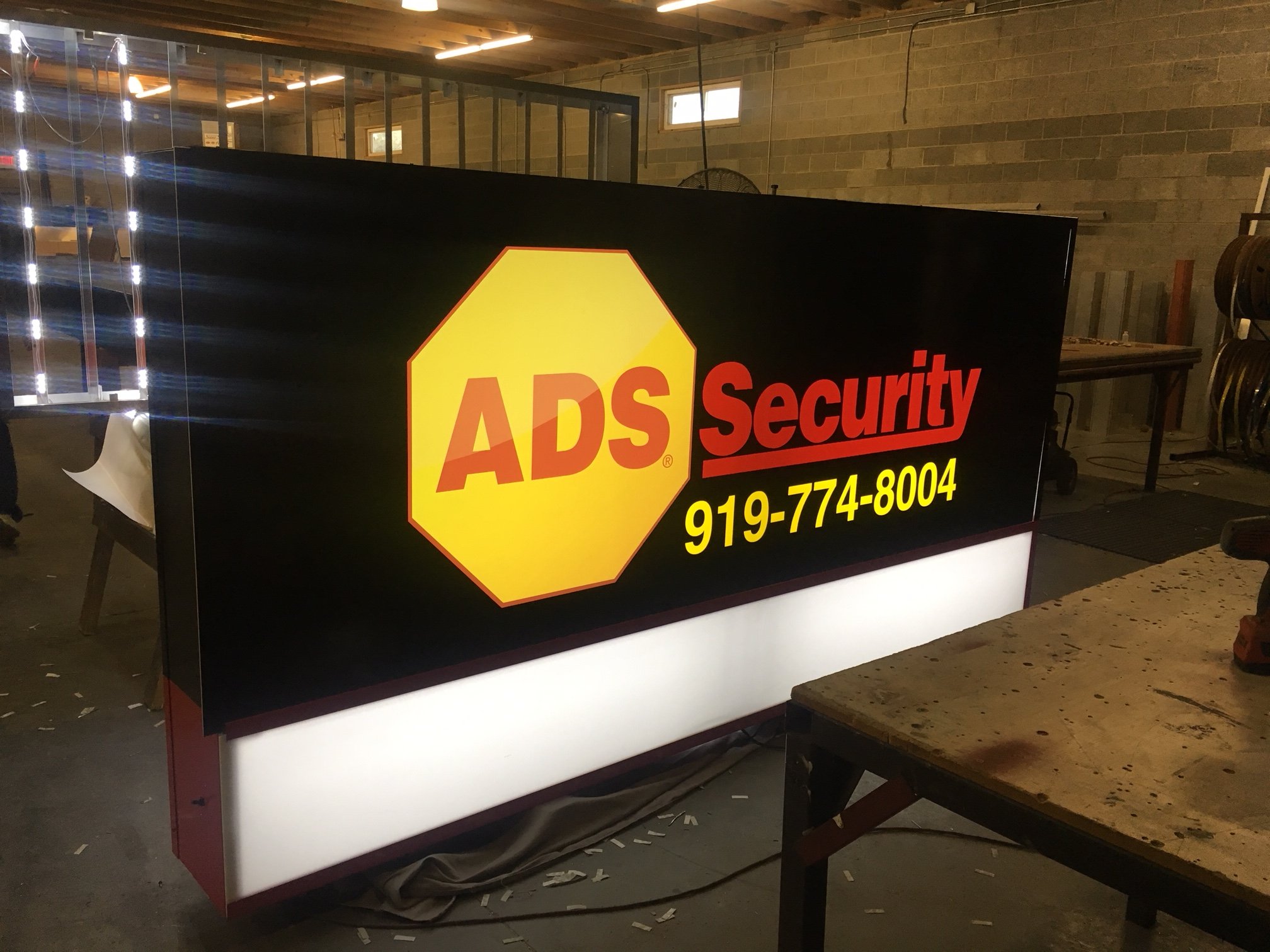

Looking for tips on printing with latex on translucent adhesive vinyl. Some graphics that we are printing look great during the day, but at night they are very washed out. We are using 3/16” high impact white acrylic and a calendared translucent adhesive vinyl and UV lamanation.

First, if you "double-strike" your print will be MUCH darker than it should, and usually doesn't work well. If i can't get good enough saturation through Versaworks, I print a single pass on clear vinyl, no laminate. Apply that, and then apply a laminated print on translucent media over top. That way you'll get the right colors during the day, and when backlit the clear print adds enough saturation. If you already have your translucent print applied you can do a mirror print on clear and do a sub-surface application; it will give you roughly the same results.
There is no way you can have a perfect contrast both frontlit and backlit but you can make it acceptable with 2x overprint and brightening up the image a bit.

That has nothing to do with clear, only their process. We use clear second surface on white translucent acrylic or polycarbonate then first surface translucent from our latex. On our flatbed we do a mirror print in backlit setting second surface and then a normal first surface print, this gives a great night and day image.

Why go through all that extra work and twice the material cost?
