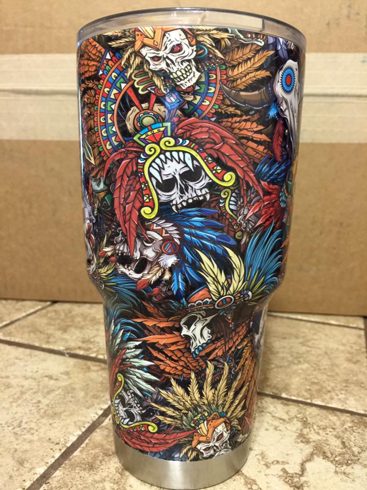

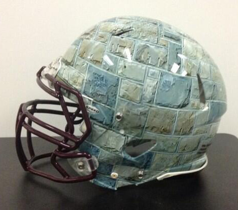

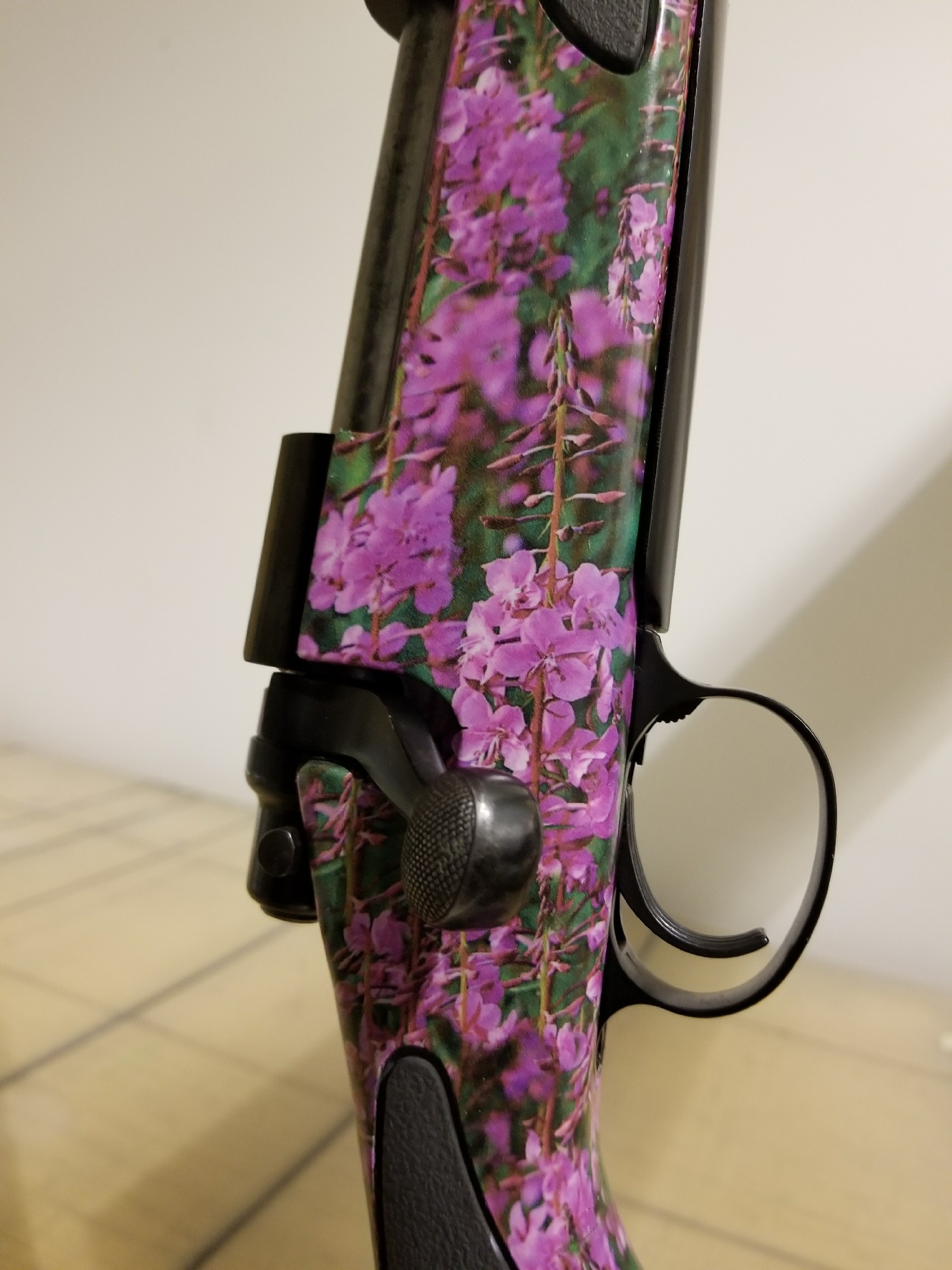

Well, if you have a Latex printer you can start printing Hydrographic film for people or for use it in-house!
I've been using my HP latex printer to print hydrographic film for the last three years... It has been a profitable blast to do!
If you guys do it, be sure to turn your optimizer level to "0" and set the curing temp to 200 degrees.
Just in case you want to see what I'm talking about, here's a link to youtube videos about it... Here
There are VERY few people doing it (custom printing the hydrographic film) right now, you can carve your own market niche while the rest of the world is still figuring it out.
You can buy the film either from China or here in the states from Ikonic in Duluth
Fireweed Rifle 1.jpg 5241a533b483c.image.jpg 13886859_307985442873483_3689089737771628543_n.jpg

You have no issues with latex staying applied?

Not a problem at all! When the activator melts the ink it is just a sticky as any other ink. Word of caution, UV Ink won't melt back to a liquid state with standard hydrographic activator.
