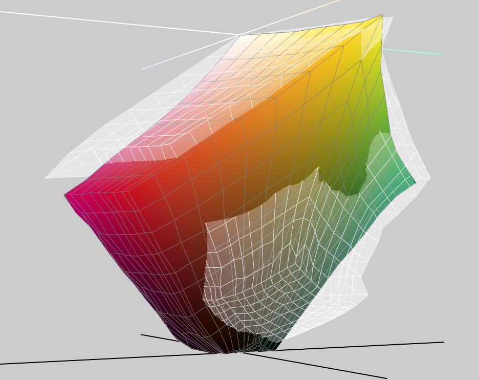

As suggested a profile was created using Flexi. Turned out horrible. No gamut to speak of along with holes in certain area. (see attached pic) Not sure what happened or why.
Best guess would be ink limits. Total ink limits ended up at 85% per channel.
For whatever it's worth it did print a nice Gray20(20% each of CMYK). No color cast when comparing to a canned profile. Will check with a densitometer when I get back to the lab.
Screen shot is my profile overlaid on Generic CMYK.
Going to try again using X-Rite only. But not before I talk to one of their techs.
