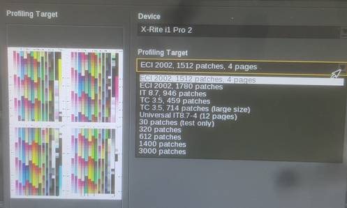

Hi guys,
For those of you with Caldera, which profiling target do you print?
We're using a iPro2 and it is quite tedious. I like profiling the media, we get good grays and good colour matching. In theory the more patches the better, but wondering what most people are doing.
Also, does anyone have an i1io? Might be worth getting to make the process faster and more consistent. If you have one, does it help?
Thanks
ChrisN
I've done the 1780 patch chart with our i1Pro2 several times. Takes a bit of time to scan manually, but I've been happy with the results.
Andy_warp
1780 for me too. I tried the 3000 patch set...it was overkill for my ink gamut.
Also, I get better results with "scramble" patches.
