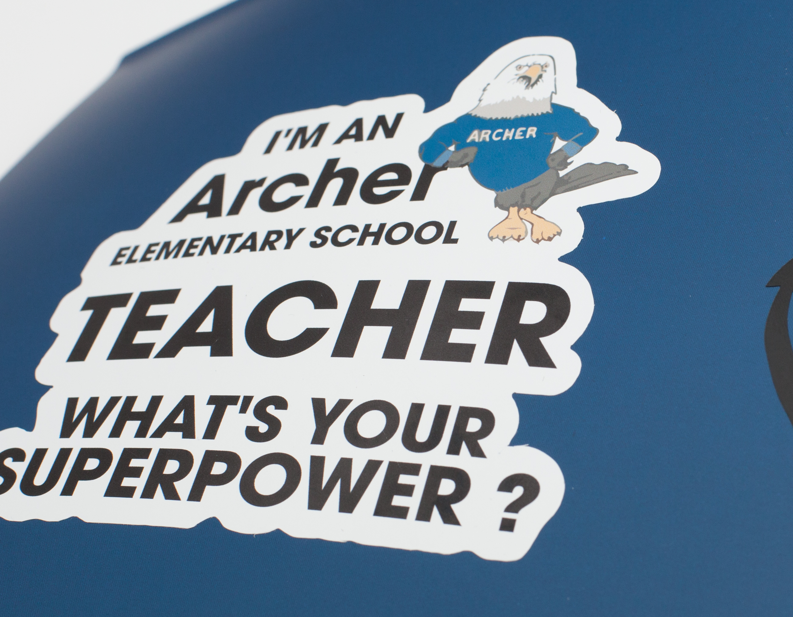

I used mimaki cjv150 for stickers it's pretty good and it has a built in cutter - download and zoom in, blue background is offset print.
