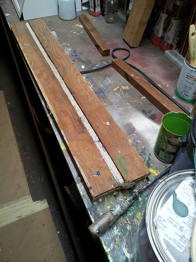

I thought you needed 200. Still, that wouldn't be too bad. This is a homemade one. Probably cost about $150 to make, then you'd be set for anything.
