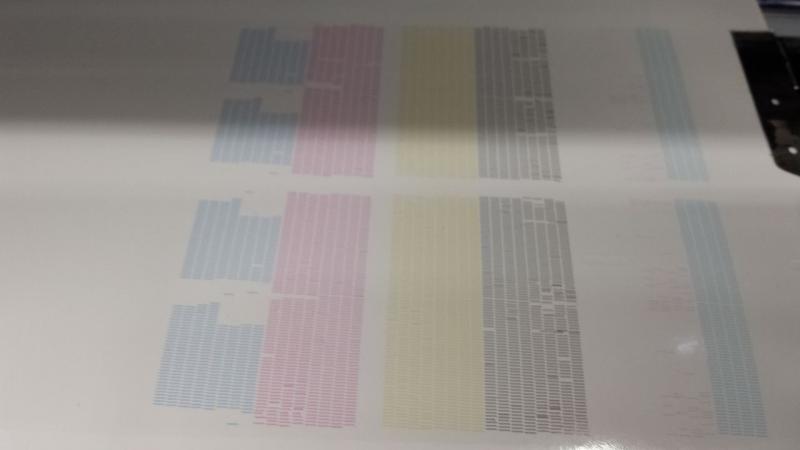

I have been tasked with getting a used Roland SC-545EX in perfect running condition. As it sits it will print mostly correct, but there is room for much improvement. IE say something we print has a person on it, they will have a green tint. We have done cleanings, vacuumed out the lines, etc. I will include a test print so you guys can maybe point me in the right direction. 20140814_124037 (1).jpg

I would start with changing out the cap tops and the wipers. If you want to open it up, change the dampers on all the heads.
PM me if you need that tech manual
