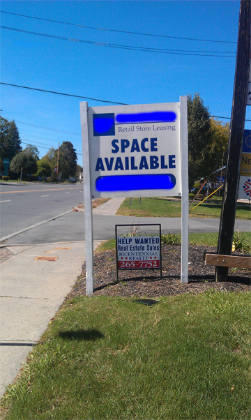

    Have a real estate company that isn't happy with their current site signs. On windy days they sometimes blow over They are 4'x4' signs on 2 3.5" posts driven about 2-3 feet into the ground. They want us to provide them with a better solution, they have 30-40 of these signs up in our area, and they will have to be relocated as different sites go up for lease.
    I'm thinking 2x4's on both sides of the posts, about halfway up the posts, and then to the ground at a 45* angle. Then drive wood stakes into the ground and screw to the new supports. I've seen them done like this, just looking for opinions. We would be relocating the signs so I'm looking for an effective and efficient way of doing this.
    Also some of these signs are an hour or two away, normally we just bill out travel time at our shop rate but I'm thinking a per mile charge would be better for this.

    Thanks for the responses. We didn't do the signs originally, so I don't know exactly how deep the holes are. I could move the sign back and forth easily with my hands, and I stuck a stick in the hole about 18" but figured the hole must be deeper than that. The real estate company is looking for a "better" way to install the signs. My other thought aside from the braces would be to fabricate some round steel discs maybe 16" dia with a square hole and sleve. Slide the discs on the posts and screw together so the disc would be about 1'-18" in the ground when the posts are 3' deep, backfill and tamp. This would probably be more work but I think it would get the job done and not look as ugly as the braces. Does this seem logical?

    Looking at the pic provided I see 4 feet of pole out of ground to bottom of 4x4 sign. That means the pole has to be 11 feet long to be three feet in the ground. My bet would be the signs are not installed deep enough. The installer also apparently does not use a level to install those seriously bent 4x4's..

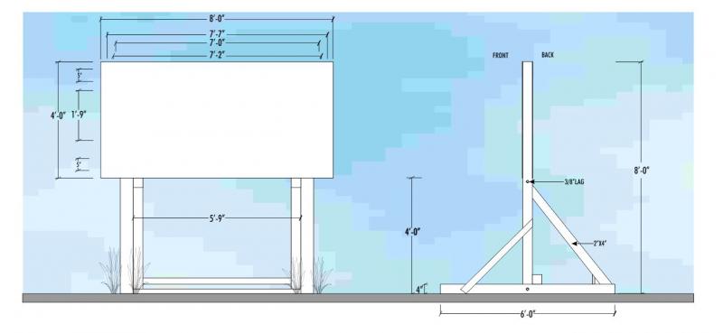

  12. J Hill Designs
    15,549
    15
    Sep 24, 2004
    Heres a 4x8 skid diagram for ya
  13. Gino
    Gino Premium Subscriber
    31,138
    1,655
    113
    Jun 7, 2006
    PA
    That's what we refer to as a 'Sled' sign.

    Thanks. Think I'll go with the skid/sled.
