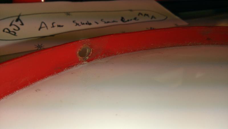

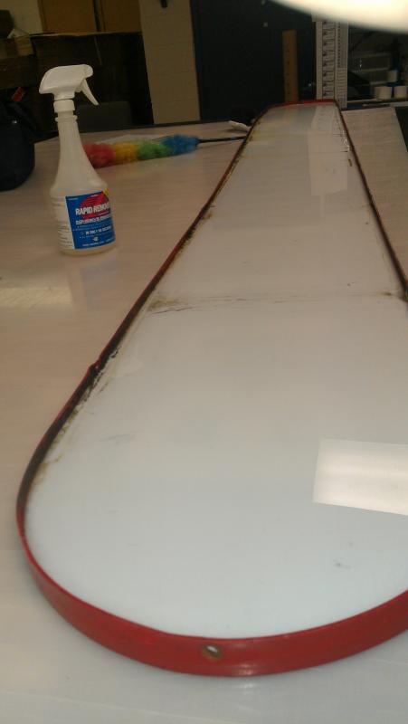

Here is a problem with replacing the sign unless there is a way to do this. This particular sign has a rim around it that seems to be made onto the white part of the sign and what actually attaches to the light box. It is not removable at all. If I have to replace the sign, how would I go about adding a new rim around it?
Also I know the vinyl used on it was some kind of Oracal and only been on it about 2 years. I know this was the wrong stuff to use but a few pieces seem to peel off reasonably ok just as a test

Sounds like you've jumped in to an area you have zero expertise. I'd send the job off to a sign company.
