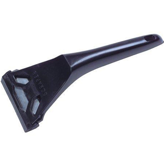

OldPaint
you need to go find a couple of these. buy em 5-6 at a time. the razor end, is at the perfect angle whe you set it down and allow the tail end of the handle to also rest on the windshield or whatever surface your trying to remove vinyl. just push this scrapper along the edge of the vinyl at an angle and the vinyl & GLUE will roll right off. google STANLEY 28-593 or ask your hardware store to order or go online and get 6.
