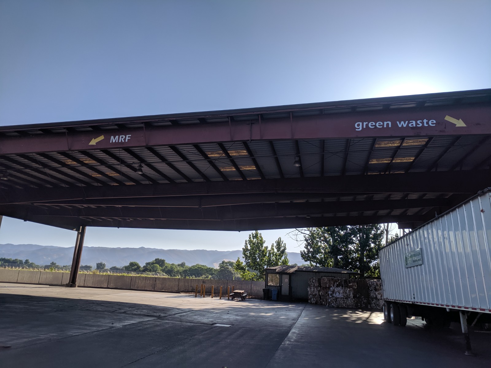

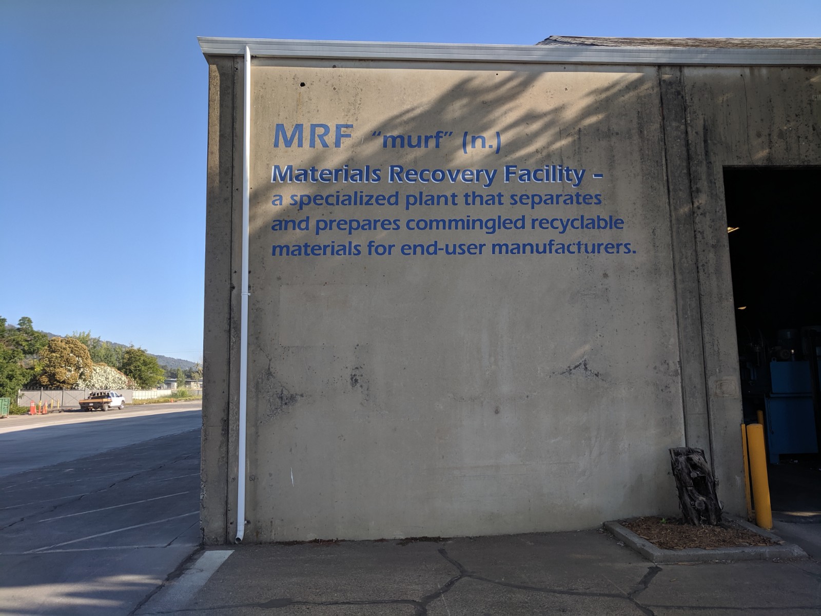

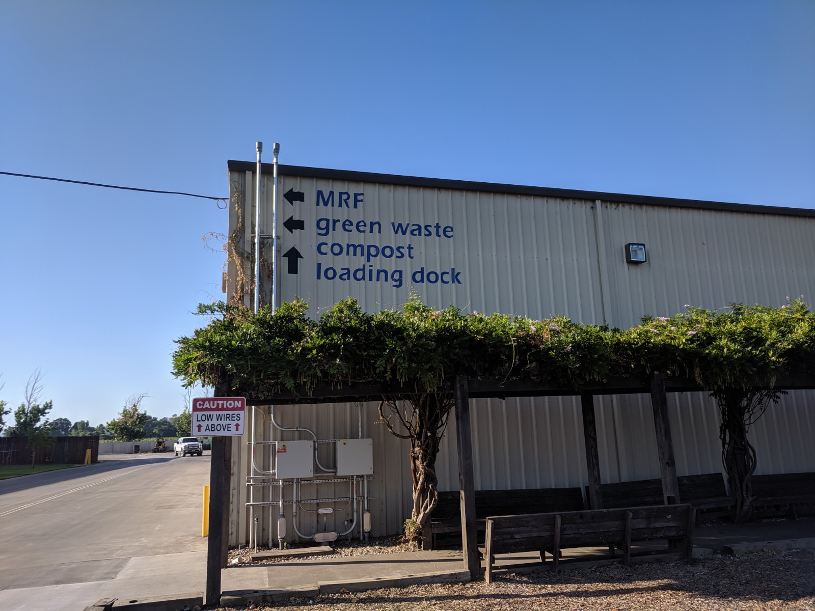

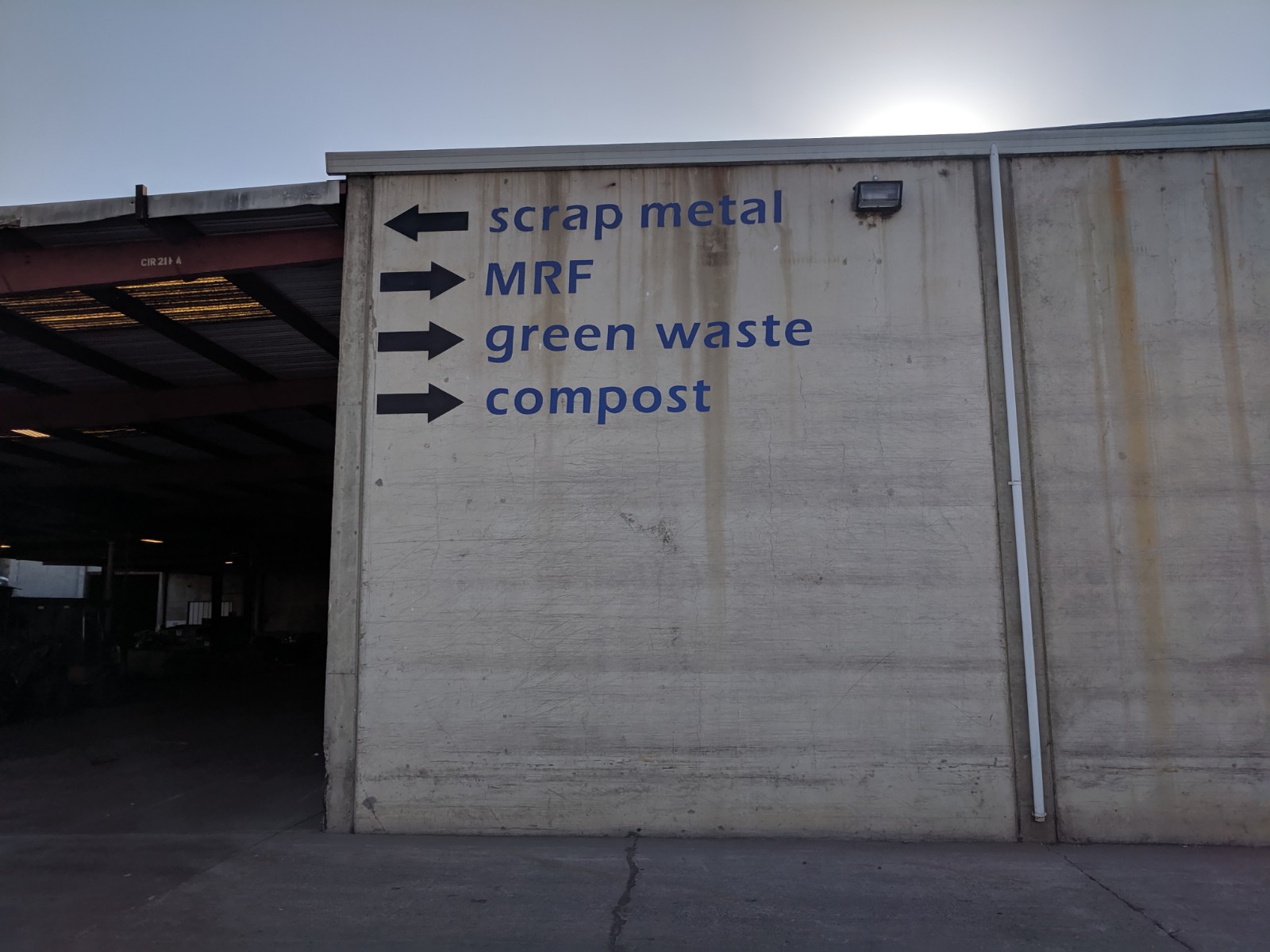

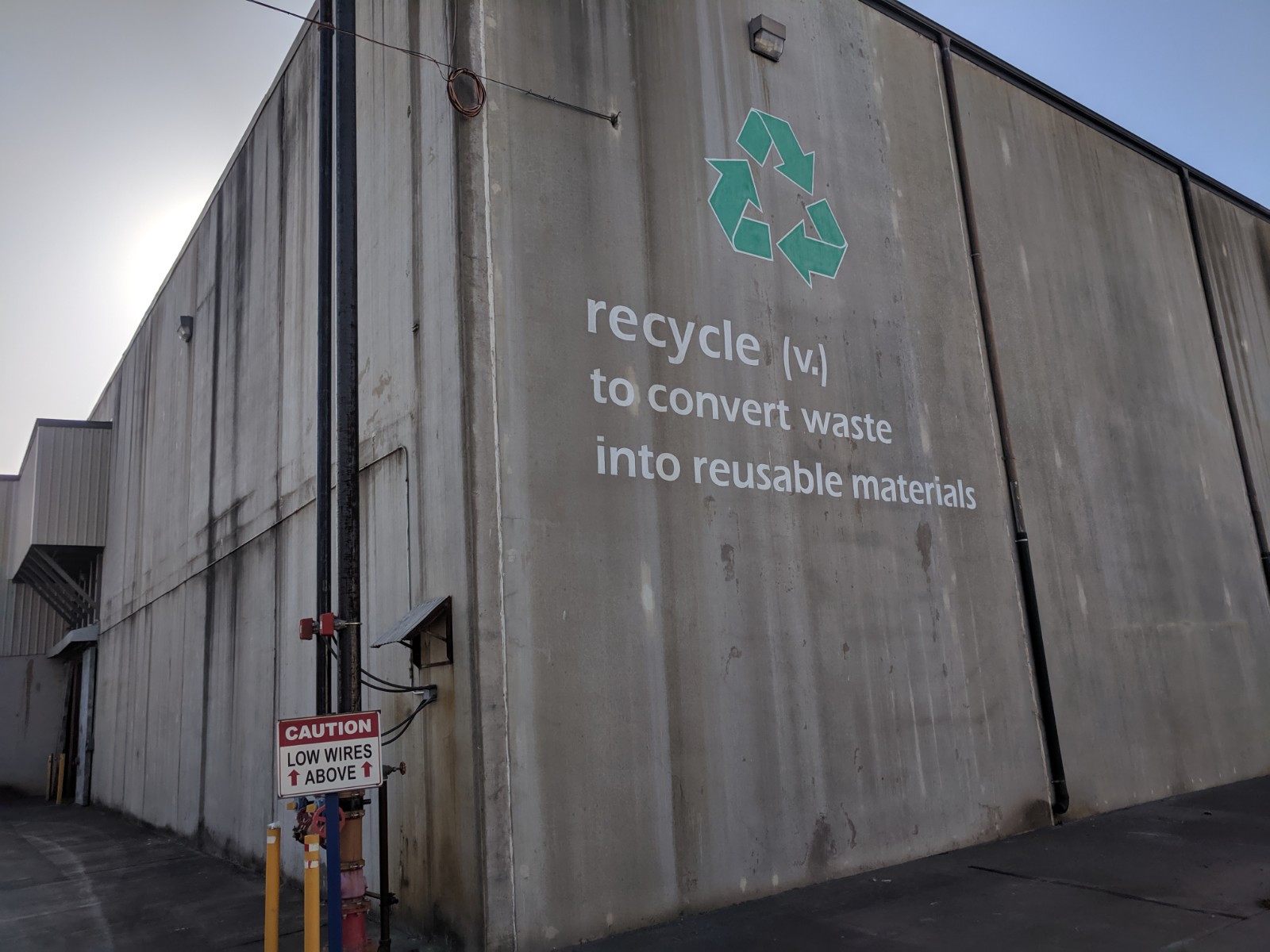

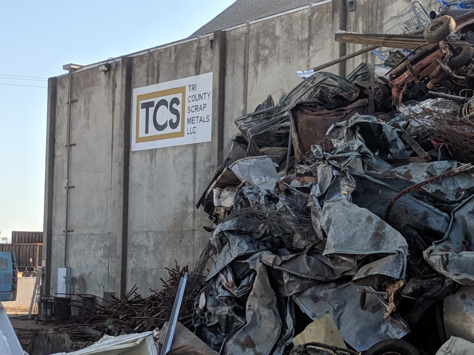

We have been asked to refresh some large format logo murals that were done on several buildings of a waste and recycling center campus here in Northern California. The only information they can give us about the original job, is that they are approximately 10 years old, and were done by a young mural artist that was traveling through the area at the time. The largest is approximately 20' x 20'.
I am attaching photos of some of the works - mostly done on the exterior of concrete - walled buildings for reference.

Those are in good shape for their age. Too bad you don't know what paint was used, it was good. I wouldn't "power" wash, just soak with a good soap/mildew/crud cleaner, scrub with a brush and then rinse. Hopefully the paint will mostly remain intact. Then paint with a good quality paint. I would test a few areas to see how it cleans up before committing to a price. I don't do square foot for a job like this, I calculate time and materials plus a healthy margin for error on a job like this

The thing to remember is that... anything near a recycling center is covered in filth. When you start washing those walls and whatnot, you'll hafta continue to a point of no return. In other words the entire wall top to bottom and end to end. Otherwise, it will look as though you painted a board on there anyway. Did you really look at how putrid those walls are ?? They will m ost likely hafta be sandblasted, primed and then re-coated, before you even prep them to take your paint. Also, I would venture to say, you'll need to alert them to the fact that most paints will not weather 10 years anymore. None, even the industrial will not stand up to exterior weather and conditions. I'd still urge them to at least look at the various possibilities.
