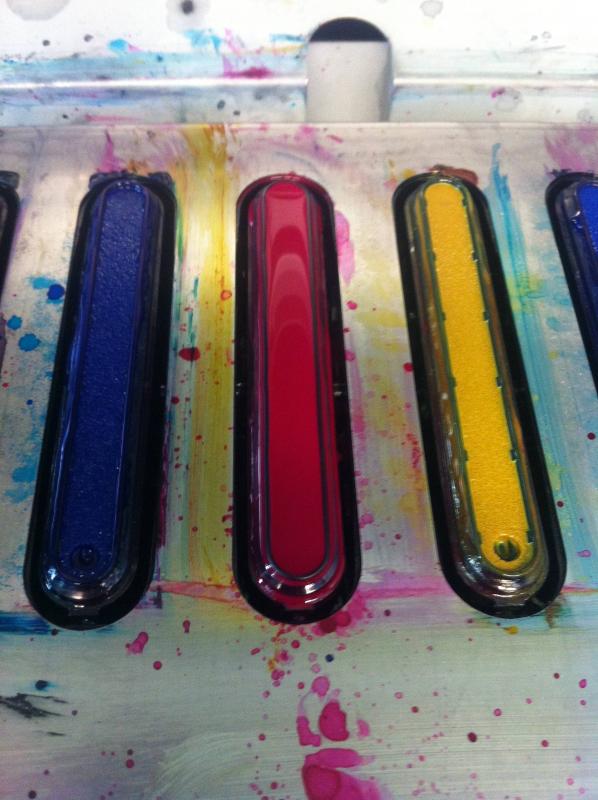

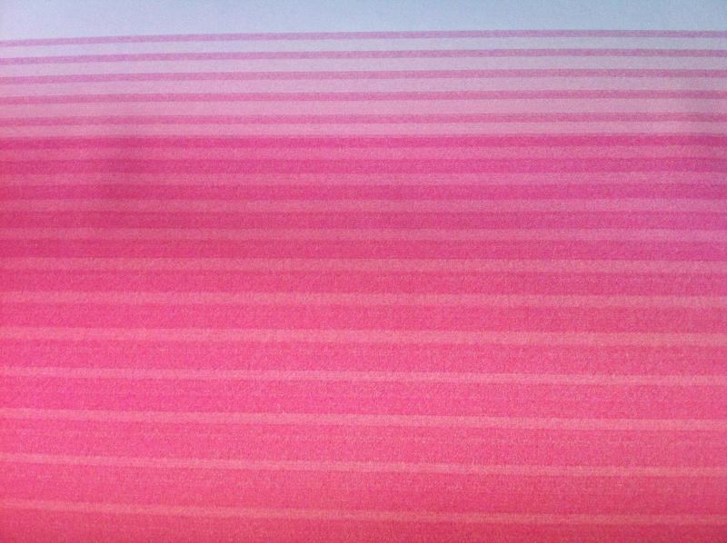

Hi there,
I have an AJ-740 which has been problematic from the word go. Various suggestions have been static on the media and humidity etc but I only seem to have a problem with magenta dropping out. All other colours seem to behave fine.
Recently this has been happening:
Magenta goes for about three passes before it starts dropping out. I've been using the machine for about 3/4 years and I've usually been able to play around enough to get it back on track but this is above my head now.
Can any of you help? Or suggest possible solutions/parts that may need replacing.
Cheers!
