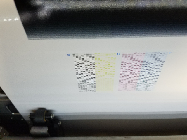

ROLAND SC545EX TEST PRINT "C"
Techno Print
THE C DON'T PRINT ANYTHING
ANYBODY CAN HELP ME
THANK YOU

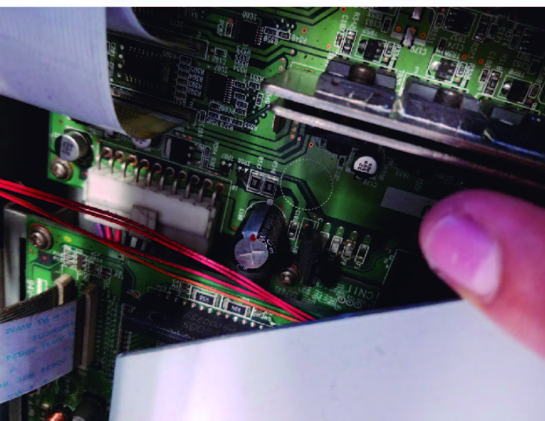

Not a single dot, likely a blown fuse. fuses are roughly the size of a grain of rice, on the main board, near where all the wide ribbon cables attach.
davyde
Power the machine off, use multimeter to check if blown. This type needs to be desoldered to replace, other types the fuse sits in a cradle and can be removed with tweezers. Fuses can be bought on ebay for a few dollars.
