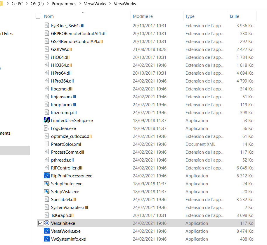

Miguel CABIT
reset your versaworks. I have this problem on my versaworks (6.9), after research I make a reset on my pc: (C:\Program Files\VersaWorks\VersaWorks VersaInit.exe
