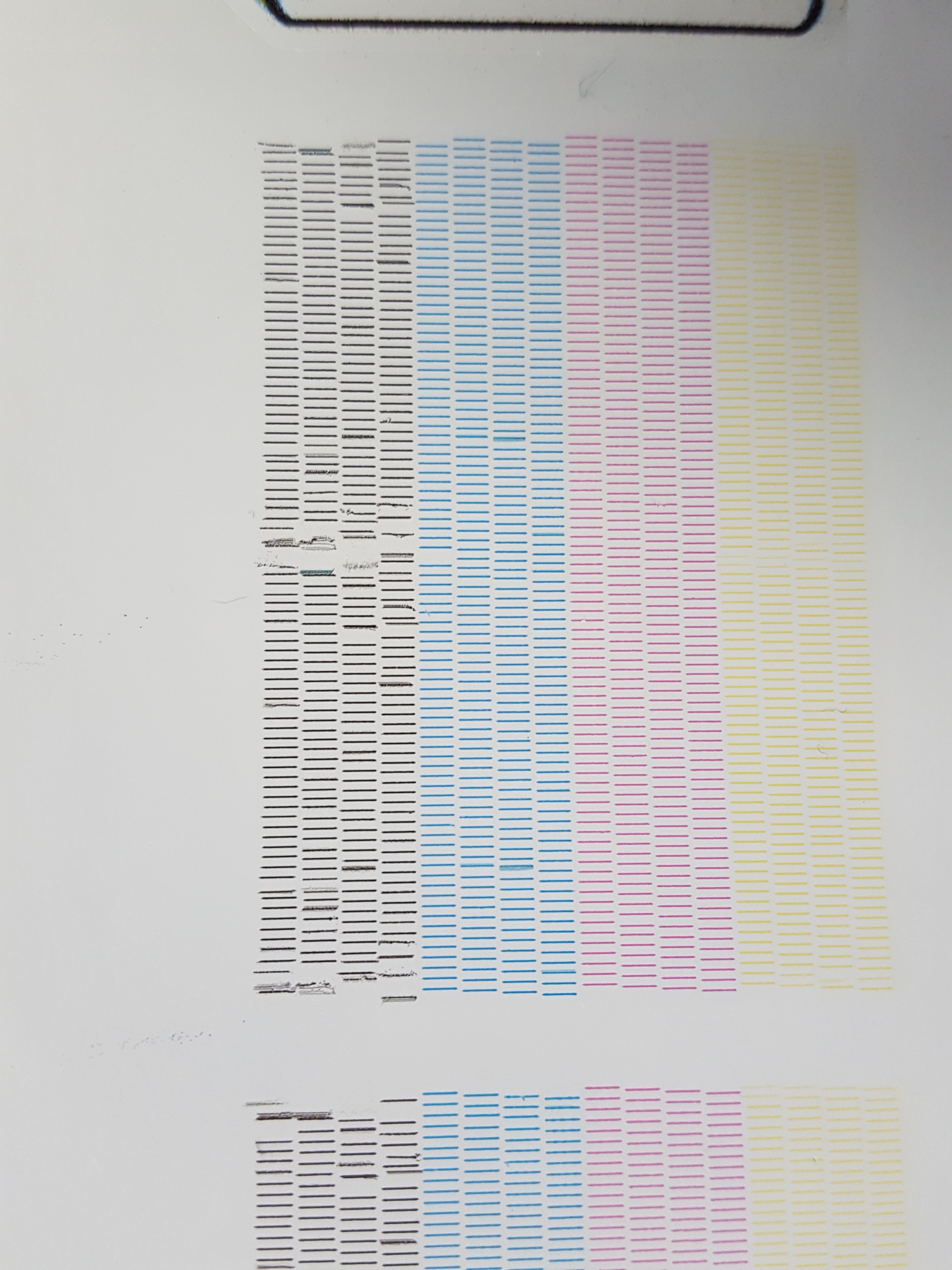

I recently replaced my cap tops and dampers cleaned the encoder strip ect.. but still having troubles. I guess I'm just looking for any other recommendations. Had a little trouble with the small rings inside the brass nuts going to the dampers but I think I got them.
Thanks,
Matt

Mysticalvibes
Not wanting to freak you out but we had a problem very similar which required a new head. The engineer referred to it as "nozzle deflection". He believed it to have been caused by head strikes!

Mysticalvibes
I see you've also some deflection in your yellow. If you look carefully you'll see a "blip" in the pattern in the second row from the right :-( I've that as well but thankfully can't be seen in the prints

equippaint
You should replace those o-rings too. They're not really supposed to be reused in any application. Looks like a bad head to me too, way worse than mine was when we changed it. Easy to do.
DJr
I've owned 4 Roland printers and this is a classic scenario for a new print head especially if you've already done a manual clean and a powerful clean. Sorry I know it's a real expense bummer!

Hey toneanddesign,
Mysticalvibes, Equippaint and DJr are all correct, based on the info you've provided, the head needs to be replaced. We recommend that you consult with an authorized Roland dealer to get a replacement head and assistance with the repair. If you don't have a dealer that you normally work with, you can find one by using out locator service online here: Dealer Locator | Roland
