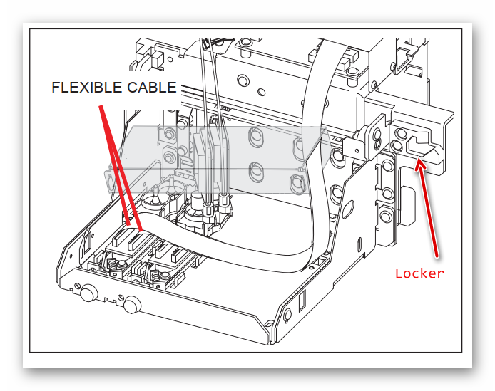

I watched multiple videos and try different combinations, but I can't have the head moving over the maintenance area ! Do you know if I can do it manually ?
Yes you can do it manually. you have to unlock carriage from home position. Simply push head to the right side and slowly release it. There are small locker mechanism on the right hand side which should unlock head. Then just move carriage across toward the maintenance station.
Eric Lemay
A big thanks to you ! I did it that way and now it's clean. I will still investigate on why it doesn't want to move via the menu but hey, I have a peace of mind. Thank you again !
