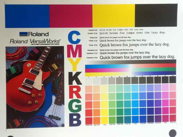

    My printer is having the following problem, no idea how to fit it, can somebody help?
    seems that the heads are not aligned.
    Any ideas how to fix this correctly?
    I have all calibrated that I know, no idea what to do next.
    I'm able to cut and crop mark cut, print is just EEwwww. 3 days of work on queue.
    :wavingflag:

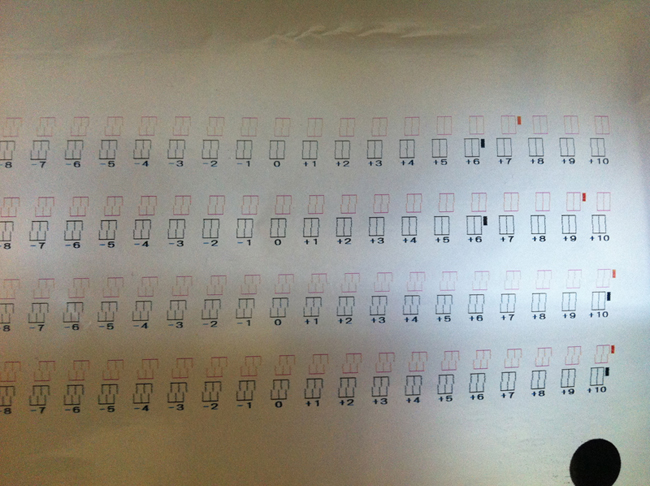

    Was this test print the Horizontal Test Print from SERVICE MODE or Regular Enduser Menu?
    Service Code 0107 is Linear Encoder Unsetup... (Encoder needs to be set up)
    Calibrations:
    Linear Encoder Setup
    Print Adjust>Horizontal & Bi-Directional
    Print/Cut Adjust
    Most cases I have seen where calibrations are off scale like that are caused by Servo Board issues.

    This was from Regular End user menu.
    let me try it on Service Mode, I follow the linear encoder set up and all the other ones to see how it goes.

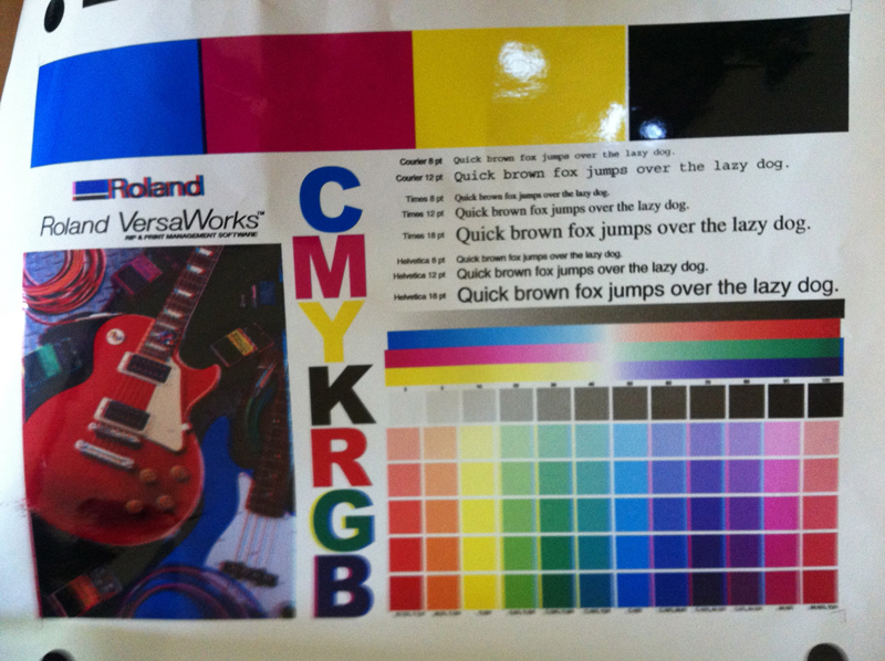

    Thanks Bobby for the service, I run a new print test and now my SP300V is working as good as day 1, I really have to do this more often, speed improved and quality on print is so much better.
    You really save the week!... Now is time to work!! :wavingflag:
    here is the new test
    Thanks Bobby!:U Rock:
