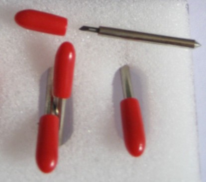

    Please compare your blade with attachment picture, it is 45 degree Roland blade.
    If you cut hard media like vinyl, you need hard blade with hard materias like Germany tungsten steel, the life will be long.
    Adam Yang from Inkmed

    Yes, I have a 45 degree. So where do you get yours?
