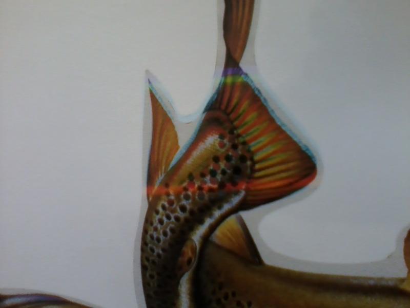

Roland Versacamm problem, why is this happening?

Why is what happening?
Are you referring to the grey area around the trout? If so, it's not a printer problem, but rather a problem with the image.
Rob_maxgrafix
It looks as if the color channels have a gap in them, you can see the image along the tail fin continues at the first color gap, but just the cyan parts of the image.
might want to re-run environment adjustment and all the print head adjustments again and see if anything is off. what does your nozzle check look like?
