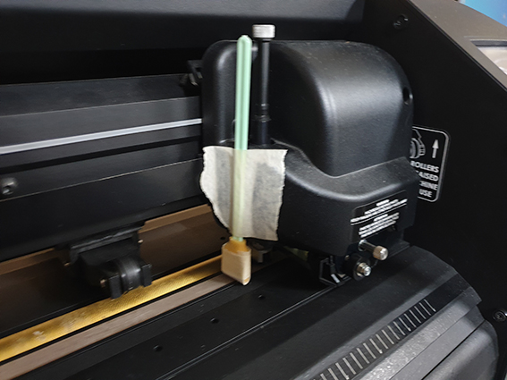

Tape a swab next to the knife so the foam bit keeps the vinyl down.
You reckon this would work? Have you done it in the past?
I'm willing to try anything because if we can't get this sorted out I'll have to print and cut on our Roland and that adds a couple days of production compared to printing on Mimaki and cutting on the Summa.
Bly
Seems crazy to have to do this to the most expensive cutter in existence but it works.
That's a bit of silicon liner stuck to the bottom so it doesn't drag on the vinyl.

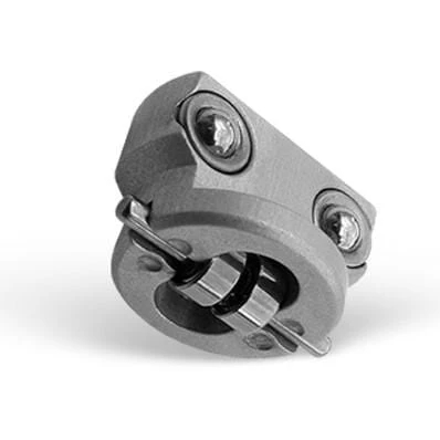

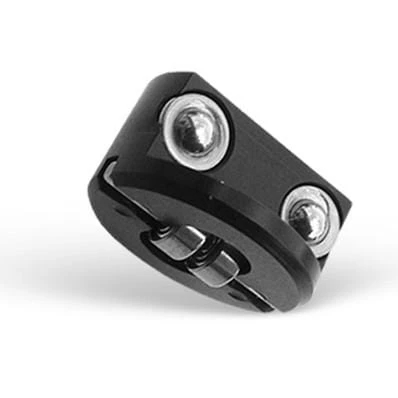

In the following images you can see a black nosepiece for thick materials (code 395-347) and the standard nosepiece (code 395-348)

Just wanted to point out that you can add additional pinch rollers to your Summa cutter and if the media is "flexing" and creating a high spot that the blade is scratching during cutting, the best solution would be to add an additional pinch roller to keep the media down flatter to the surface of the cutter. You could also change the nose piece as Jerry suggested, but you would also need to change the blade to the thick materials blade, and for materials less than 10 mil thick you wouldn't be using the correct blade.
Here is a link to our web store where you can purchase the "media select kit", which includes the pinch roller assembly, roller, and clip that you would need to install another roller - https://www.airmark.com/products/media-select-kit. I also have installation instructions that I can send you if you do end up buying the kit.

Tessellate
It’s a shame but we have the same cutter. Few rolls a week get cut and it never gives us any issues other then the vinyl scratching you speak of and sometimes some misalignment when cutting 8mil floor lamination on 40c for some reason...
we have adapted the “swab” trick As the photos have shown. I tape two q-tips onto the head as it’s cheap insurance. They usually last around 2-3 weeks before the cotton begins we wear down to low. At that point we simply replace them with two new ones. Since doing this around a year ago we haven’t had a single scratched piece of laminate since. Looks funky but I suppose function over form?

Good to know, thanks! I've tested it out and it does indeed seem to work. I guess there's a fine line in terms of how much pressure the swab is putting on the vinyl - too little and it doesn't keep it down, too much and it's buckling when the cut carriage changes directions and I would imagine it would eventually stress the motor. 2 laminated rolls to cut today so I'll keep my fingers crossed!
