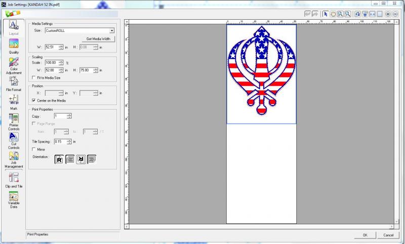

    I have a roland 540v using with versa works. The image Ive shared shows the actual print and cut. The white space below scrolled all the way out and then came back to cut the symbol. Is there any way to avoid this headache?

    It looks like your graphic is just slightly wider than your media, so VW automatically tiled for you.......nothing printed in that space because it was probably just the eps margin that accounted for the extra width
    I don't know
    I may be looking at your screen shot wrong, but that's what it looks like to me
    Try reducing the dimension of your graphic so it fits within the media measurement and I bet it won't happen

    lolz. yes. your image tiled. :) make sure that the image you are printing/cutting is smaller than the width of your media.
