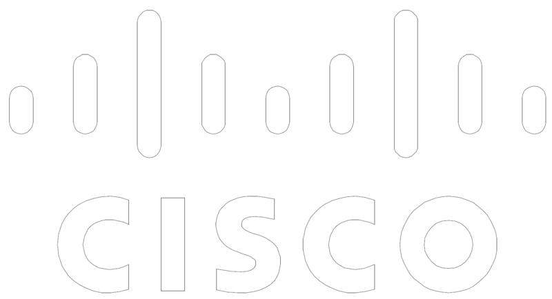

Hi Everyone,
I had a last minute add on to our project and the contractor wants us to provide side lit 1" thick letters. I called Gemini but they dont make them.
Cause timing is of the essence I want to know a) how i can make them b) where can i order them.
So here is my question.
First and for most what kinda material is the acrylic? Is it translucent acrylic?
Second, the drawing calls for routed channel in the back and a self adhesive LEDs like in the picture. is this doable. Any help would be appreciated.
If you can think of a wholesaler, that would be awesome also.

Post a picture of what you're actually looking for. There are so many ways to light acrylic up. Post what you're looking for and someone will be able to help you.
henryz
Hello Armandolo, will the faces be non illuminated? 2 ways on doing it. Embedding the leds inside the acrylic usually about an 1 1/4" thick, the other is to backlighted with a tape similar to the one on the picture you will need an aluminum backing for heat sinking. Hope this help, we had to do these letters before but after some errors we finally got it.
