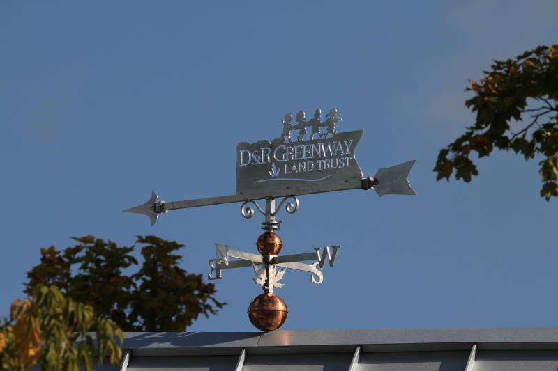

These are a few we just completed.The weather vane was a lot of fun.

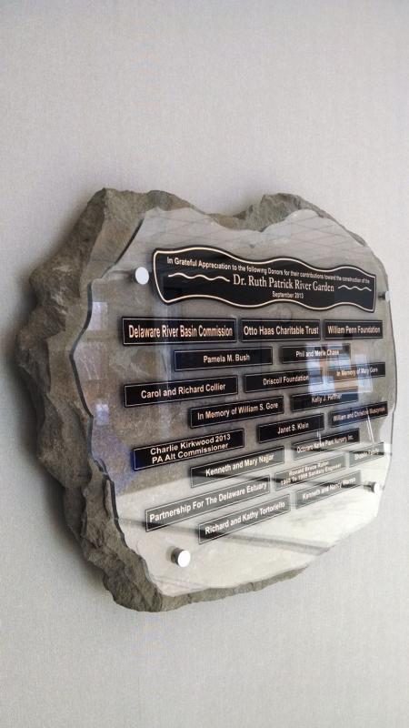

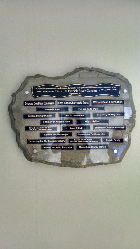

how did you mount it? that is pretty awesome. great job on the outline for the acrylic too!
1.5" steel angle tapconed on the back 1.5" steel angle on the wall.
Pins on the steel attached to the rock lined up with oversize holes in the steel attached to the wall.
We just dropped it on and walked away.
For the acrylic we took a picture of the rock traced it and cut it on the router.

For some reason I'm really fascinated by the rock sign. This is the type of project I would love to tackle. But no one EVER has asked for this type of thing.
How did you come to the decision to use the rock? Your concept? Or customer request?
Where did the rock come from? Was it a prefabbed piece? Or did you/customer find it?
Did you smooth the surface yourself? What about the holes? What type of process/bit to get through it with clean holes?
Any pics of the back bracket set up?

The customer wanted to use the rock for a dedication plaque but wasn't sure exactly how they wanted to go about it.
This was a fun project because it was for a discerning customer who is willing to pay for uniqueness
and we were given free reign to conjure up whatever we wanted.
Not all jobs are like this and I still have to hang out on the edge of a bucket truck and do other boring sign work to eat.

It was for this project so you can see where the rock comes into it
http://www.state.nj.us/drbc/home/newsbytes/approved/20130923_patrick.html
They supplied the rock
and we drilled it with regular masonry bits
The bracket was something similar to this

Very nice work, thanks for sharing, especially the mounting details, always good to know how people tackle these situations.

Z SIGNS - was that glass or acrylic ? (shines like glass).
I did some 2' W x 5' H x 0.5" T donor boards one time out of tempered glass.
To be etched on the reverse with categories of 'gold', 'silver' and 'bronze' donors.
The glass company etched their brand in the lower right corner. ¾" square.
WTH ?
Even the most fun projects have their minor glitches.
All of your examples were cool. (and fun).
