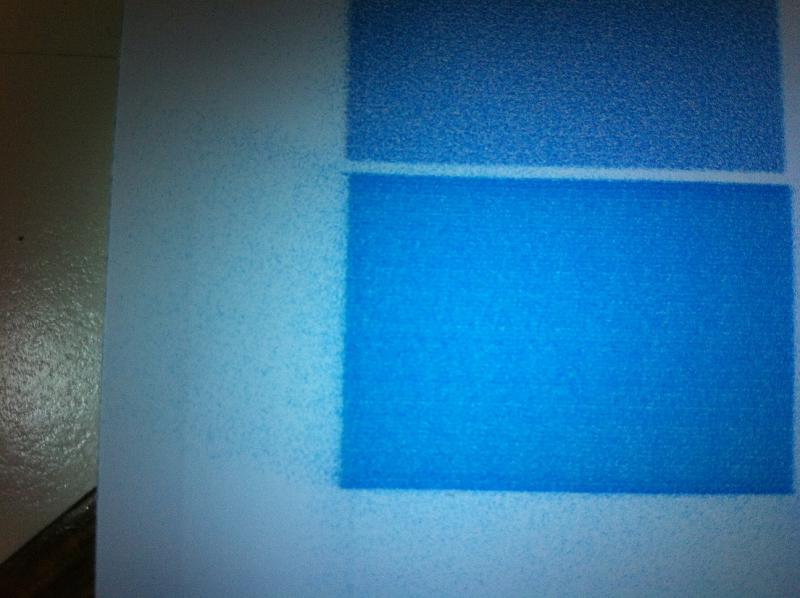

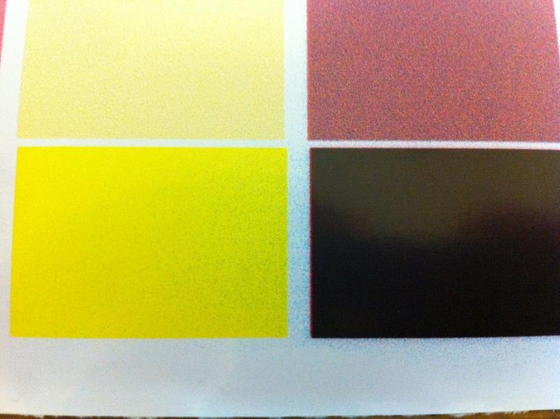

Im getting print "splotching" Not sure what the correct term is..
any ideas why this happens?
*pic attached* shows a square print of CMYK each square being 100% of each respective color, and 0% of every other color.

Hard to tell from pix, but the Cyan looks to have "overspray" which could be a dusty reader strip. Other colors look to be starving which could be any number of things. What inks do you use? When was the last time the dampers and cap tops were replaced? If a 3rd party ink is being used that leads to things like clogged lines ruined dampers, etc... Sorry I am not more help.

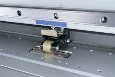

i also had the 0.0 reading and it turned out to be the following: the silver metal on my pinch roller has become loose. It is held on by a little screw which in order to get to, you would need to take apart the whole top end of the machine. The silver part gets read and if its not in its normal position it spit out a 0.0.

Cut carriage cable could be your sheet set error problem. The "splotching" is probably the cap tops. I've had both those problems and those were my fixes. It's a good place to start anyway.

Now your cyan overspray is another story. What does the nozzle test look like? Can you post a photo?

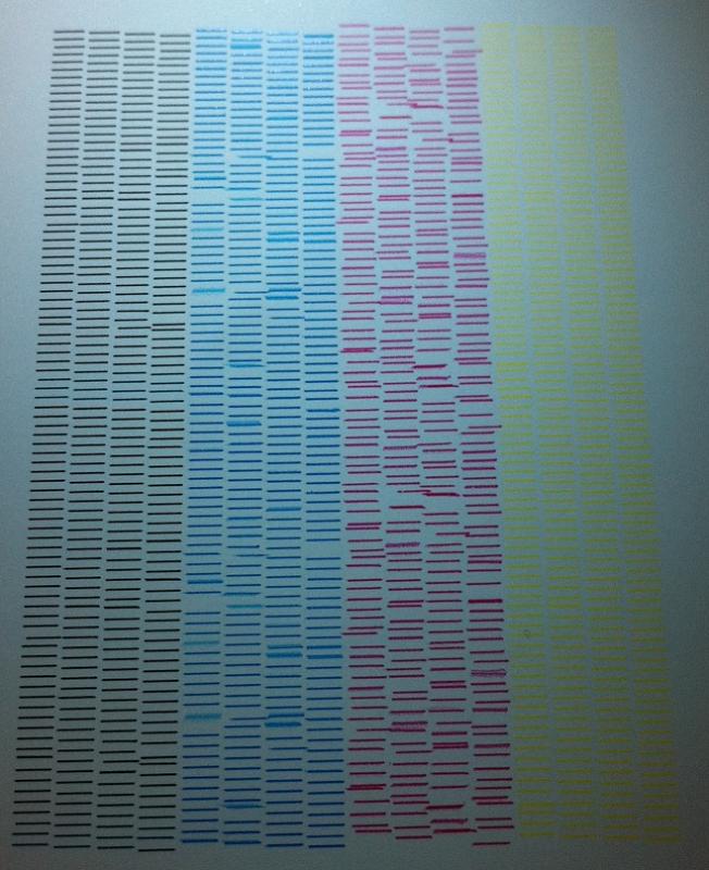

Now Im getting another issue... While printing, magenta seems to stop printing completely. Sometimes it happens in the middle of the print, sometimes near the end, sometimes just after it starts.. :(
Mine are a little loose. Ill try tightening the screw see if that helps. thanks!

Heres a pic of the test print from this morning

With that test print (nozzle check) your heads have to be towards the end of their life or your using 3rd party ink. You have way too much deflection going on to produce a great quality print. For your "Drop out" on magenta, look at the captop, is the sponge swollen to the point the sponge is higher than the rubber edge, if so replace. Also if you haven't replaced the damper in the last year, go ahead and do that as well (Roland recommends changing them every 6 months). In laymans terms the dampers are like an oil filter for a auto.
My .02
GTSTech_1
Using roland ink.
So theres really no way to fix that then other than buy new printheads?
Havent replaced the damper in... 3 years...
and the captops dont seem to be swollen.
Never replaced them either.
CS-SignSupply
Your magenta head looks permanently deflected. Buy the captop and replace it... run a clean or two and do test print. See if the new captop helps at all. If not, I suspect the head is not going to get better on its own.
Curious... have you changed the wiper or wiper scraper ever?
EternalAudio
I replaced the wiper maybe 8 months ago.
I have two new captops on order as well as new dampers. We'll see what happens when they arrive.
