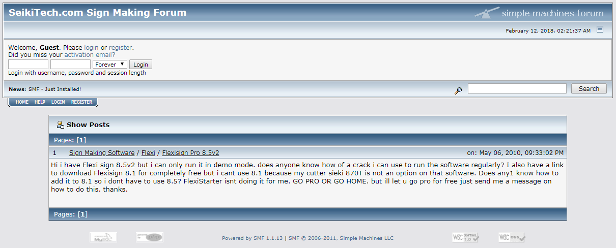

    0igo remember this?
    i told you dont claim to be better than some of us.

    Lol bro no one claimed anything. I just had a laugh at the other guys response. Why you so sensitive lol. You're the reason for the wall

    I failed to find humor in it but cool.peace man.
