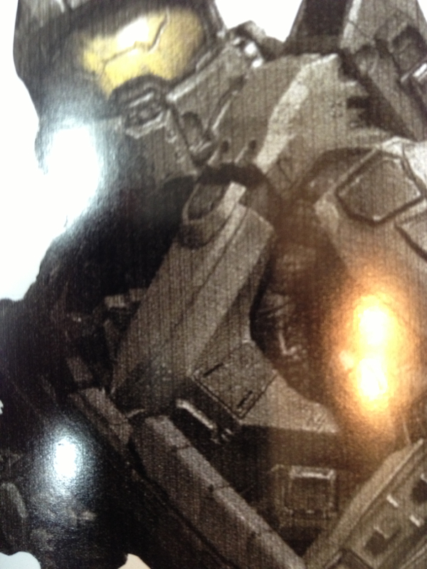

    Any suggestions on how to get rid of these? Thanks.
  2. J Hill Designs
    15,549
    15
    Sep 24, 2004
    if nozzle check is good, its probably a feed comp issue

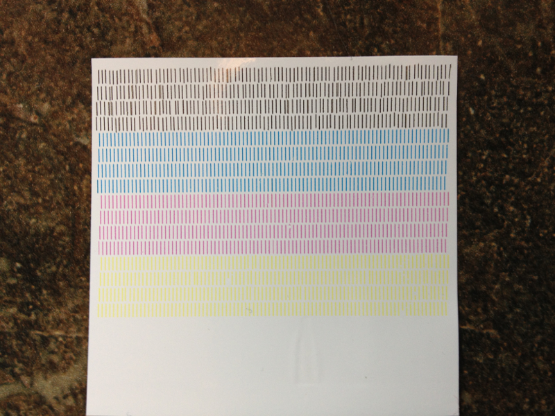

    Here's what the test shows.
  5. J Hill Designs
    15,549
    15
    Sep 24, 2004
    yup I'd say that is the reason for the lines. manual clean, head soak, etc.

    Well did the head soak and a couple of medium cleans and wow what a difference in prints. Here's test sheet after head soak. Thanks a lot for the help.
  13. splizaat
    splizaat Very Active Member
    1,206
    3
    38
    Sep 19, 2007
    Pac NW
    WOW...your black head is deflecting pretty bad...but those look much better. I'd try printng a bunch on it and see if the test print clears the black head up at all in a few days...if it doesn't it might be getting close to needing replacing.
