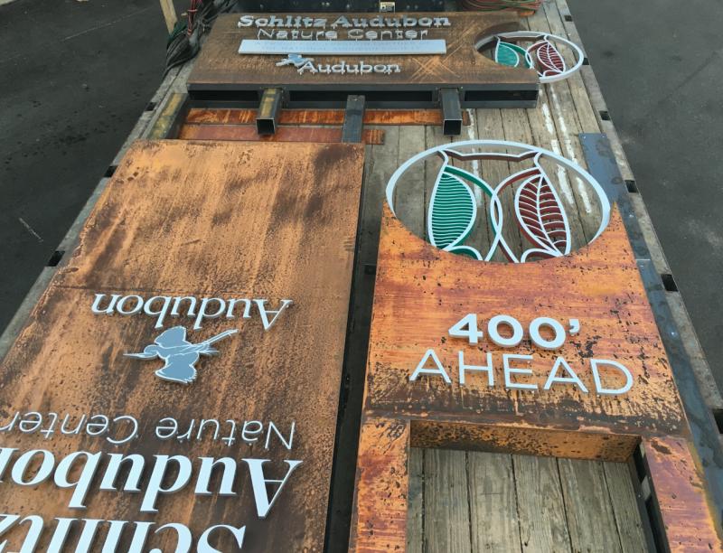

food for thought. dont just let the steel rust, rapidly oxidize it either before or after install by spraying with a solution of saltwater & hydrogen peroxide.
pretty awesome, and less chance of having bird poop/debris dictate how evenly your panels oxidize outside on their own.
2B
What is the ratio of salt to water and how much saltwater to hydrogen peroxide any instructions that you found to best apply this? I've heard than vinegar also works to rust steel?
MikePro
sorry for derailing your quest for a waterjet cutter, but I'm such a nerd with it comes to neat details.
I learned this originally from youtube vids & trial/error, except there's really no error aside from the mess/stink you make.
Can't find our exact formula we used at the moment, but you really can just wing-it: i believe it was something along the lines of 1/4 cup vinegar, tablespoon of salt, and a couple cups of hydrogen peroxide.... and then added water to fillup rest of the spray bottle. Saltwater is enough to rust steel on its own, but vinegar/saltwater accelerates it to the point that you'll start to see it rust in an hour and brilliant rust-coverage overnight.

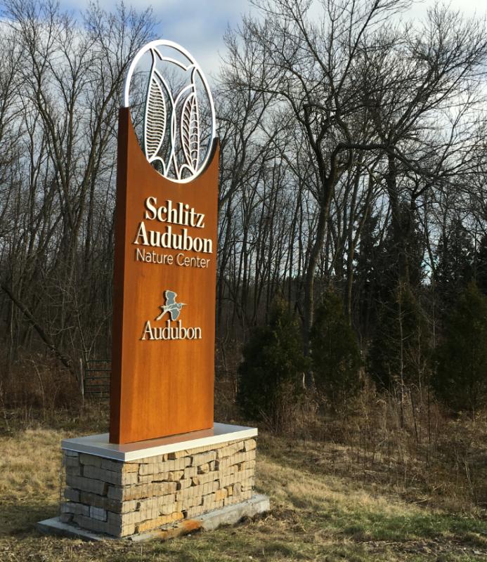

pics shown, sprayed night before, assembled&installed next day. Patterns come from welded spots and/or handling prior to spraying. If you want it more evenly-rusted, then give a light sanding after initial rusting, and spray again.

Go ahead and lightly sandblast your panels. Some sheet steel is pickled and oiled (P&O) and you may get uneven results otherwise.
JB

If you're placing your signage on limestone caps, make sure you seal the limestone well to avoid streaking.
