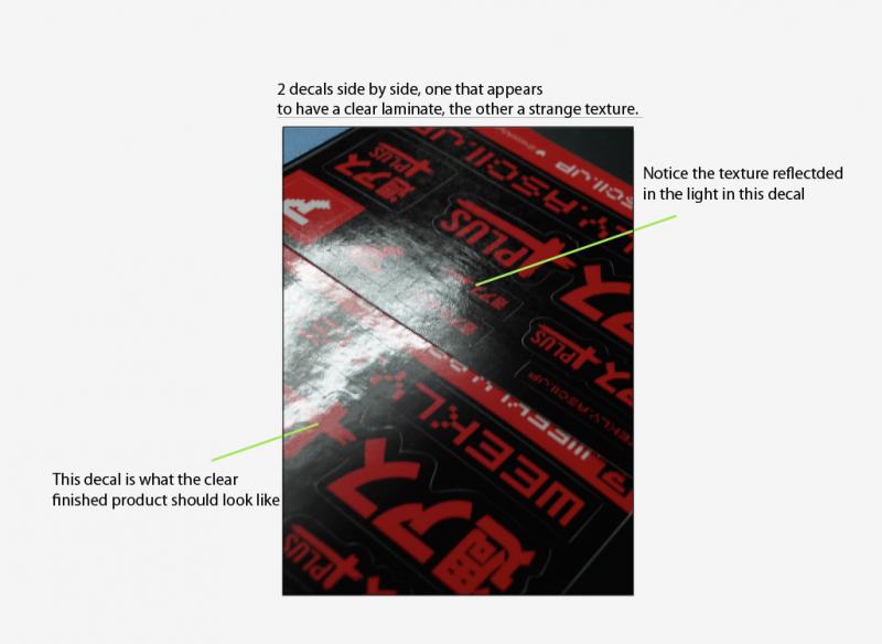

    Hi Guys,
    Anybody know what would cause this? We go through rolls without any problem, then suddenly the laminate appearance looks different...

    Possibly "mottling" ... read about it HERE.

    Thanks for that link. Sounds like it might be either the mottling or orange peel.. I will try to keep an eye on where exactly on the roll this is appearing. Thanks again.
