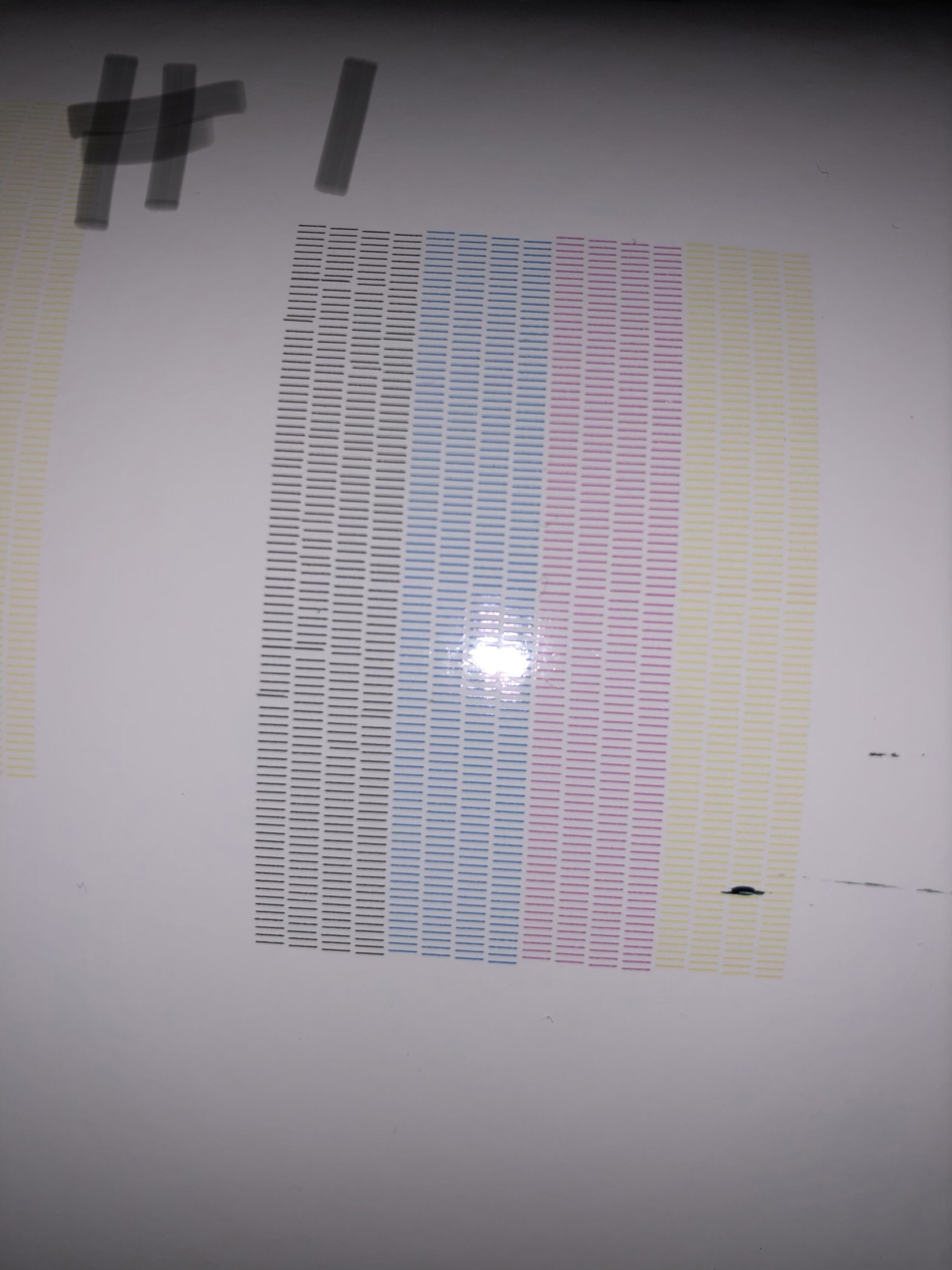

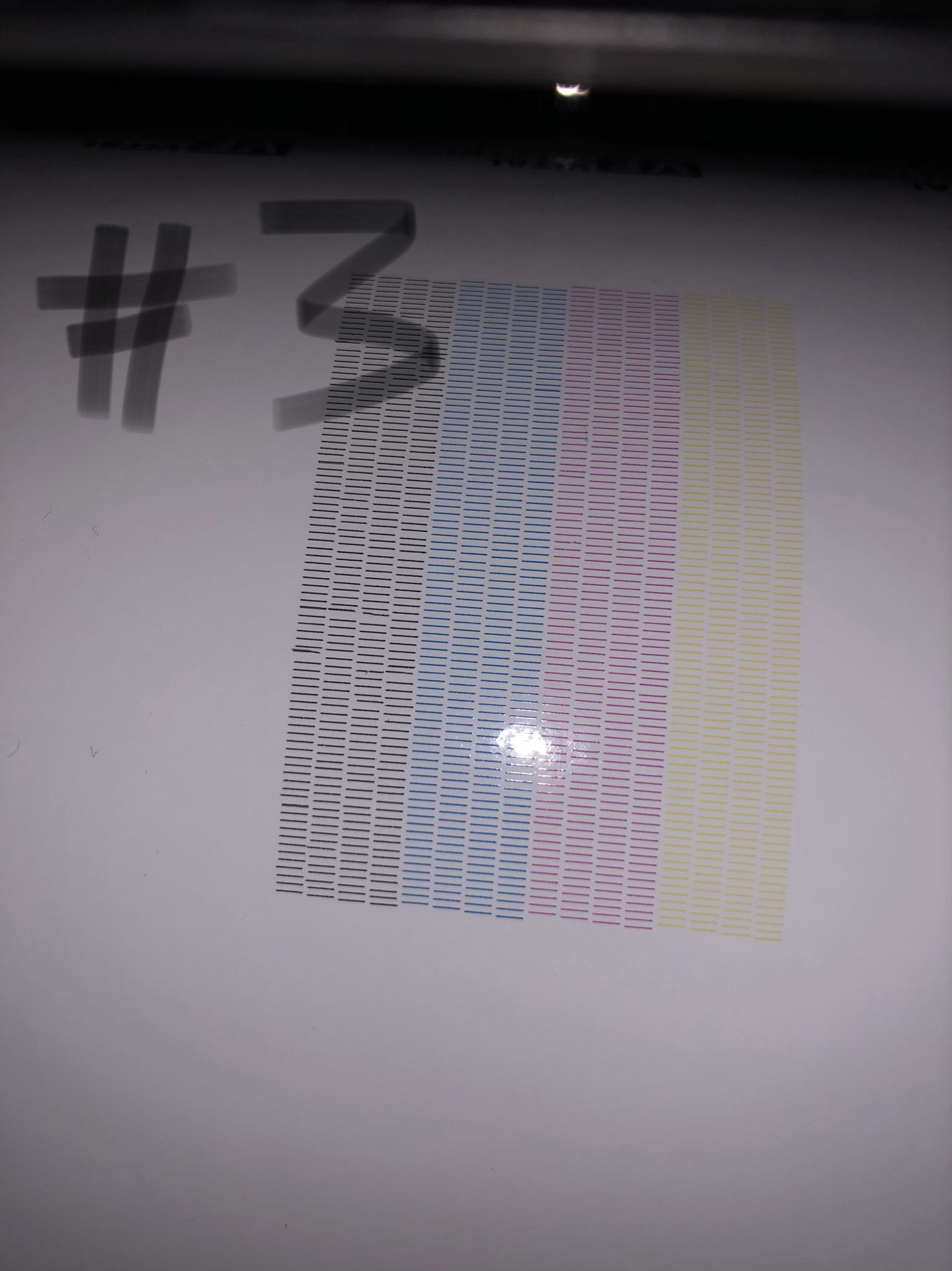

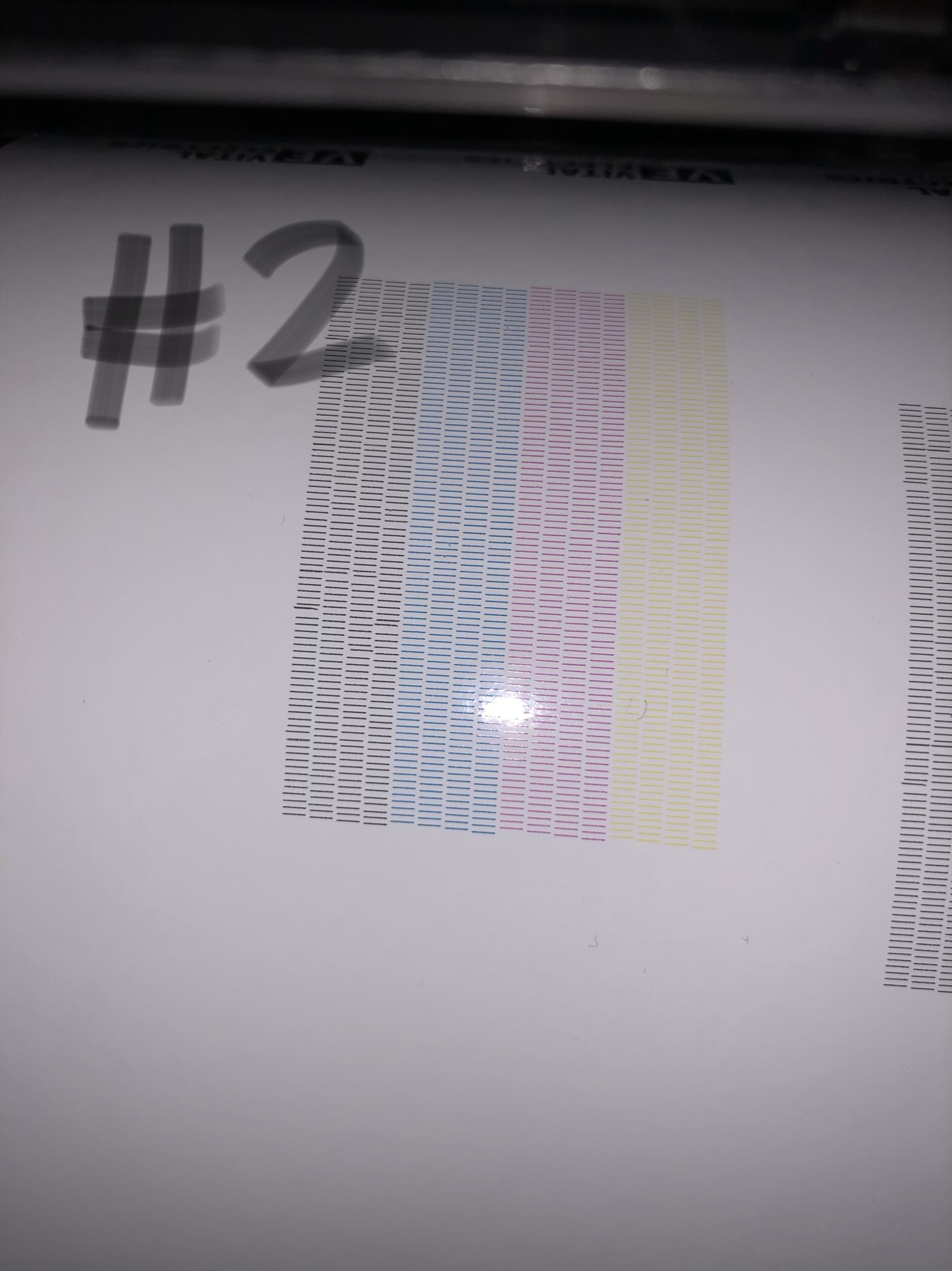

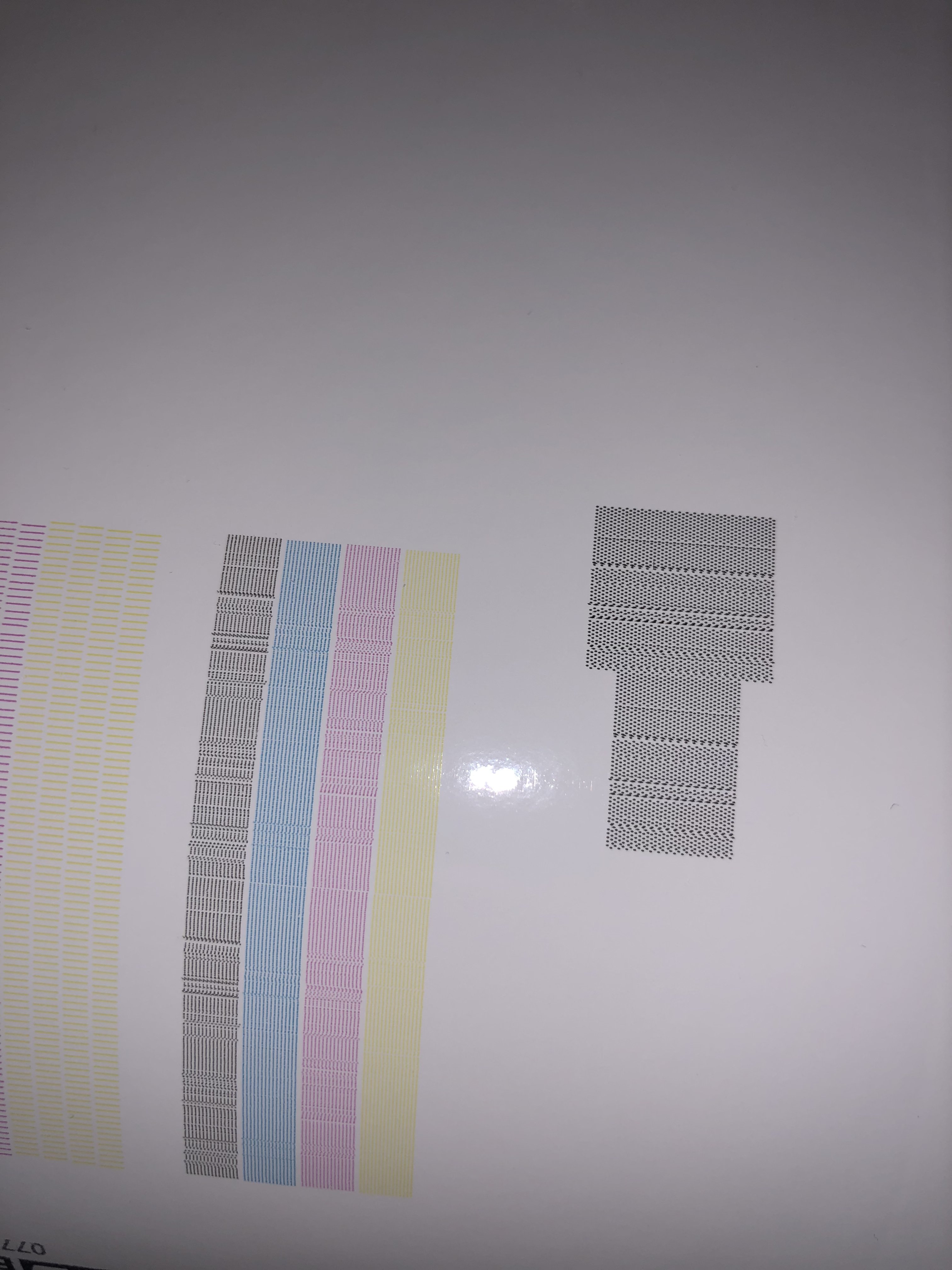

Need Help Test print issue.
SignMeUpGraphics
Super Active Member
Boy that is a lot of deflected nozzles for only one month old heads.
I'd start with new cap tops and a few deep cleans, but I also have difficulty believing the nozzles are that bad after a few weeks.
Terry01
Roland printer.. Check your power lead and take up leads are not laying around the leg of your printer.
It looks like a static problem.
Michael Snook
Hello,
I shall look at the leads, I’ve been covering the machine with a bed sheet, maybe that’s causing static.
They are only one or two months old.
Thank you.
hbb2008
Humidity plays a big role too. if its too dry in your room, then it can cause deflections. I use Waterbased ink and when that happens its hard for my head to recover from that even if the humidity is is between 45-55%
