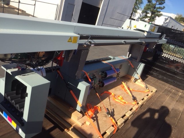

All my XT‘s I’ve moved without the crate.
The two tables are not a problem at all, and the e-box with gantry can easily be fixed with straps.
There is no need for the crates! Every relocation company can do this.
