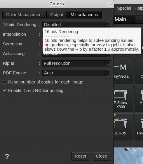

Caldera supports 16 bit processing. On the Print Screen click on Colors. The click on Miscellaneous. The change 16 bit Rendering to enabled.
