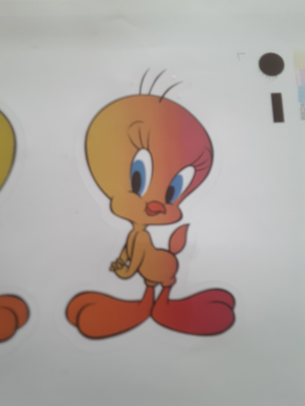

Need Help Versacamm SP-300 ... what the heck is this?

    the first and the last ones were half orange. The rest were fine

    Show a nozzle check. Are the colors correctly assigned?

    Looks like my magenta and yellow are overlapping

    You have cross contamination. Usually it's caused by a clogged/partially clogged cap top or pump. The cap doesn't drain fast enough so the ink receded into the other channel. I usually just flush the lines to make sure they aren't clogged. Other than that it could be a weak damper not holding the pressure properly or the worst case scenario is the head is damaged internally. .

    Tweedy Bird got a good tan :p
