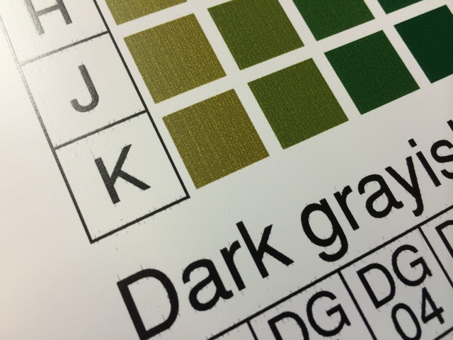

Hello - brand new member here. I did a quick search and saw some similar posts, but not quite the same. I've had my SP-300i for a couple years, but feel like I don't know much about it. I've tried a regular and manual cleaning. The first pic is from the VersaWorks color chart. The upper half of the chart looks great. The black text and boxes around the entire chart have black streaks on them and the colors on the bottom half of the chart have banding. Is this an issue with the black? I don't think any black ink is used to print the colors on the top half. The third pic is the calibration and I don't remember ever printing one until recently, but I don't think it's supposed to look like this.

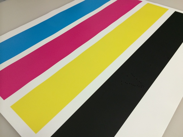

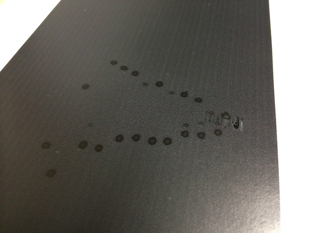

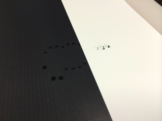

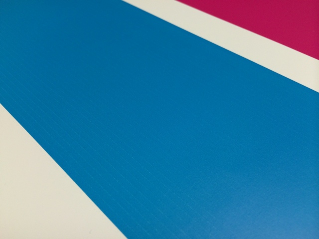

We printed some large stripes and here's what we got. The second image shows some droplets we got on the black stripe. I don't think we've actually had this problem before, but you can also see banding in the black print. The yellow and magenta look good, except that we used 100% yellow and the print didn't come out 100% yellow. It looks like there are cyan and magenta specks throughout the yellow stripe. The third image shows banding in the cyan stripe. Since we hadn't seen droplets in the black before, we printed the stripes again, and the fourth image shows banding and droplets in the black, and some black smudges next to the stripe.

I would look at changing your dampers. The blue is printing a perfect test pattern, but is banding, like it is not getting enough ink. That is what I was getting and it was the dampers.

The black dripping could be a bad damper seal, or the caps are clogged, or you are not cleaning it properly.
When you manually clean the heads, never touch the bottom, only the sides. Look for a hair or something that might cause the ink to collect and drip. I put a small mirror under the heads on the far left cleaning position, as well as a small LED light.
When cleaning the caps, fill them with cleaner, let it drain, then wipe around them and the top, but never touch the sponges.
