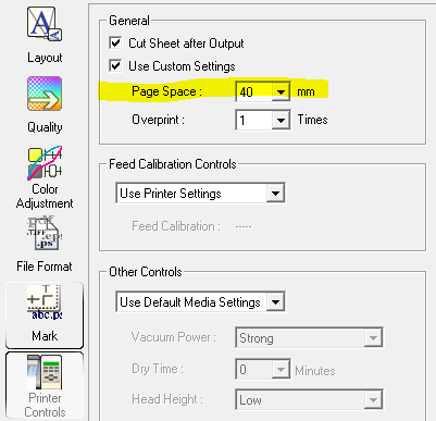

I don't know what other Rolands are set at, but my XR-640 is default to 40mm of media at the beginning and ending. That is fine for the beginning, but for many cutting operations that require me to refeed the media in, 40mm is not enough media at the trailing end for the printer to detect crop marks safely without the edge detector running out of space. I like around 80mm in those types of jobs.
Typically, when I have long runs, I load the media up and reel back the leading edge as far as it will go and set page spacing INSIDE versaworks.
Alternatively, you can use CustomCUT in the Layout tab in that particular job to set a specific page height and never fuss about extra material. Make sure your artwork does not have extra white space and that it IS just the artwork that needs to be printed.
