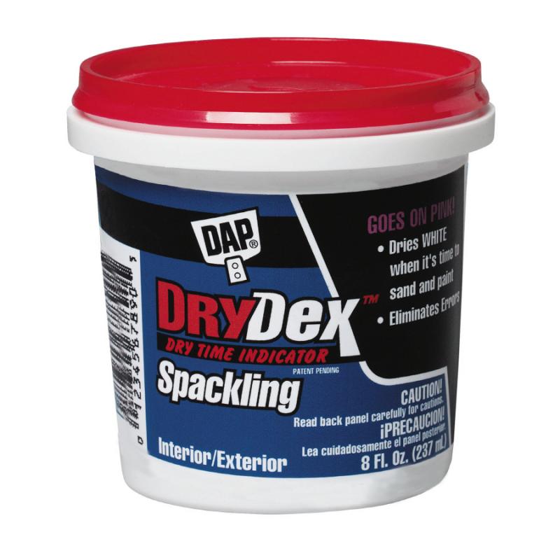

    Your customer is gonna love you when they go to take the signs down and destroy the signs, the wall, and the emotional stability of anyone within earshot.

    Ok Pat, also use this.
