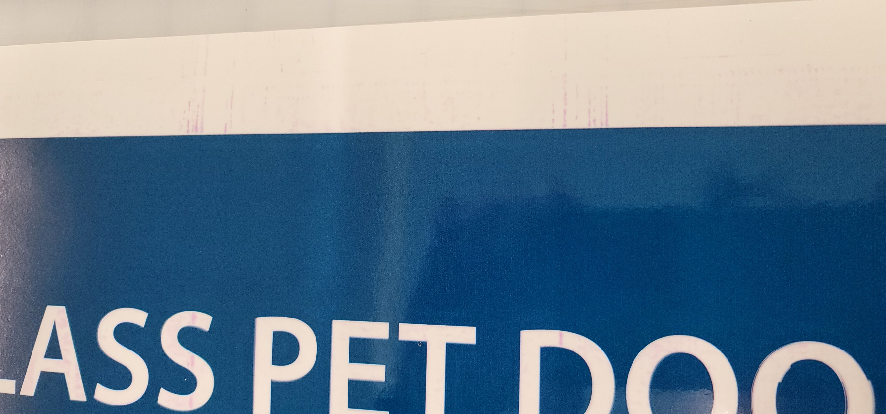

Vinyl print ghosting / lines
jeffkics
Sign Says
Any idea why this would happen on Avery vinyl 2903 but not on 3303 or 1105?
Jester1167
Raise the humidity in your shop and see if it helps. Before you go out and buy a humidifier, grab a spray bottle and fill it with water and spray the bottle around the shop floors then try printing again.
On a side note, it will keep you from getting shocked all winter, especially on the laminator.
Jester1167
It may not be static, but for us banner material was the worst, and a plastic liner tends to build static at a higher rate than other media.
You've also narrowed your problem as a media-specific problem by saying "my 1105 prints this exact file perfectly".
