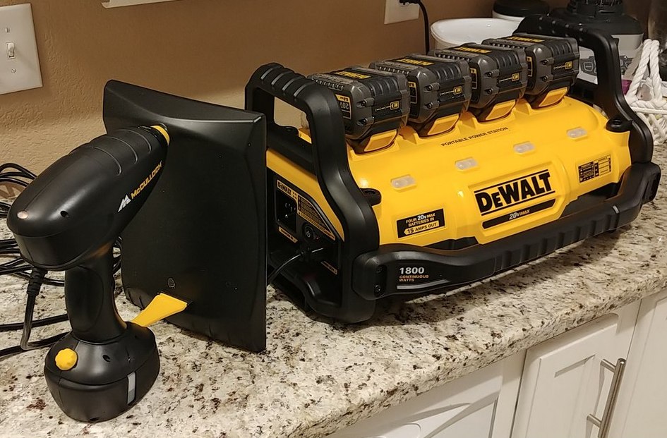

Using the DeWalt Power Station to power this McCullough steamer. Works great for removing vinyl. Portable, no on-site electrical needed, no chance of scraping the glass from using a scraper and removes all adhesive residue.

I typically use a 4" scraper with stainless steel blades and water with a heavy concentration of dish soap when removing letters. The intent of this setup isn't to remove small amounts of letters. I received the Power Station the night before this removal and was eager to test it out. I was simply showing how easily it loosens the vinyl.
I bought the Power Station and this particular steamer primarily for removing large pieces of vinyl where there isn't electricity available, where a scraper shouldn't be used (acrylic/polycarbonate faces), where a generator can't be used for the larger steamer (below), etc.
When removing entire conference rooms of privacy vinyl, large vinyl graphics, etc., I use the setup shown in the video. The generator is obviously only used outdoors.

Yep, when it's easier to use a scraper, I'll use a scraper. When it's easier to steam it off, I'll use a steamer.
Scratching glass with a razor blade is pretty easy and I see a ton of glass every week that is scratched from someone that scraped off vinyl in the past.
The day I removed the Wing Stop vinyl it was about 40°. Using a blade would have left residue all over. It took all of two minutes to remove the vinyl and it didn't leave any residue.
