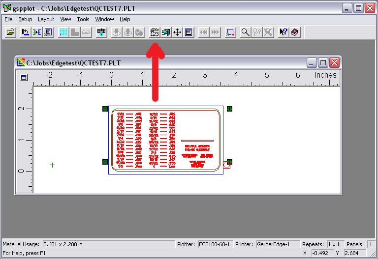

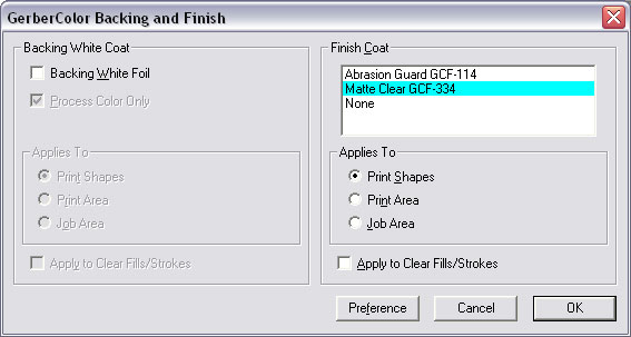

    • Both Duracoat and Zeronine make a clear printable foil that provides both UV and abrasion resistance. Gerber makes only an abrasion guard foil. Your question, therefore, indicates a lack of understanding of your options. Combined UV/Abrasion Guard foil, if needed, is applied as the final printing step. It is usually accessed in the 123 dialog - see examples.
