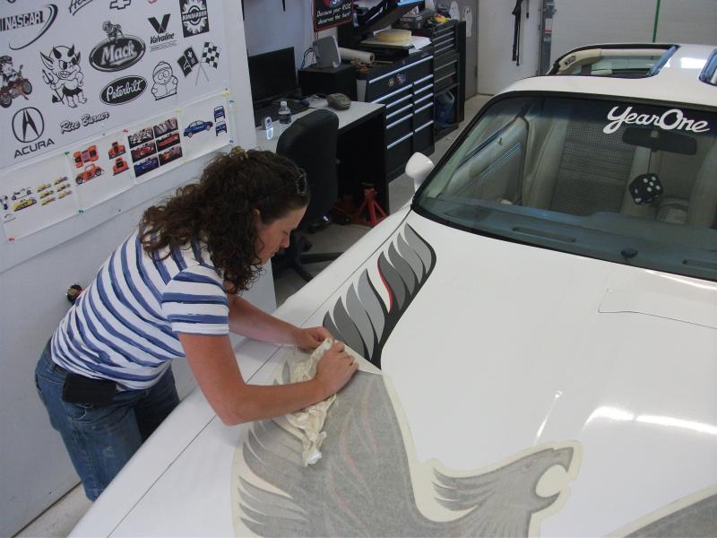

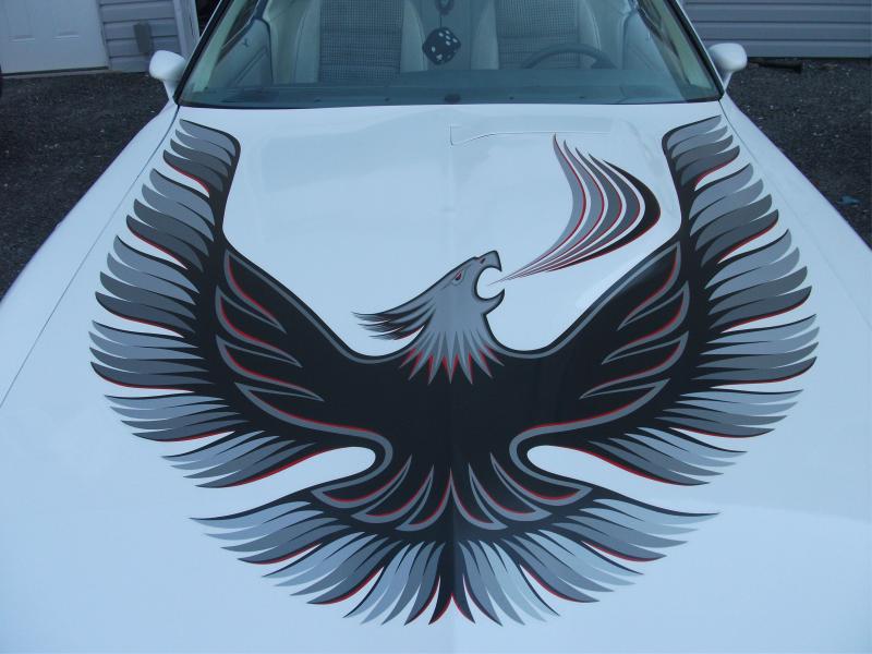

    I also use Rapid Tac II. Spray both the hood and the back of the decal, lay it in place, spray the top of the transfer tape, squeegee the crap out of it, let it sit for a bit ( we had to let it sit much longer then a minute because of that clear backing ).
