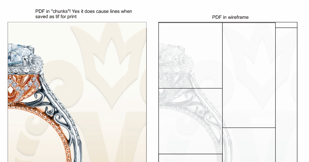

We've been given a pdf as a "print ready" file. We don't send the file straight to print without checking it for proper size and such. The 1st method we try is importing to corelDRAW that way any vectors are retained. If that looks a little squirrely we'll try and open in illustrator. If things still look a little off as a worst case scenario we'll open it in photoshop flatten it and save as a tif. Downfall is vectors are rasterized too.
Anywho, oftentimes these pdf's are broken into "chunks" and people on this forum will say "just print it, their won't be any lines". Uhhh wrong
My theory is that the parameters weren't set properly when the pdf was created.

95% of PDFs we get do this. It's annoying. I just save as .TIF or .JPG depending on the final output and never have lines show up.

Yep, that's what we did and got a black line through it. I did notice that the line will appear only at a certain zoom level. I think I'm gonna try and nudge that one piece about .01 inch then rasterize it all.

I see this on most of the pdfs with placed art that I print. You may want to consider not moving things and printing a test (crop down to one of the areas you expect to see lines). I see the white lines in Illy when I look at it on screen, but I have never had the lines show up in the print.

A lot of times the lines will not show in print, we typically flatten the files. I believe when the files come in that way they are designed using InDesign or similar programs and not Illustrator/CorelDraw. I am dealing with one now that is saying when they convert the fonts to curves/outlines it is making their text look fuzzy and they are using InDesign to set artwork.

The PDF process breaks it into chuncks so that it can open faster. The best way is to rip it in photoshop. Don't export from illustrator as a rastor. Just open the supplied PDF in PS.

You could also ask the customer to supply the tif/jpg already flattened...or like mbasch said open the PDF directly in photoshop, which occasionally will still show the lines in which case you could clone stamp the line out VERY quickly, not ideal but solves the problem without troubling your client. And as Superior_Adam mentioned most of the time the lines don't show in the print, but on rare occasion they do. So it's always worth a quick print test before trying to edit the flaws out. I've never liked PDFs for this reason as well as how they can mishandle transparencies and clipping masks sometimes too. AI, PSD, TIFF, and EPS are my go to formats. Best of luck :)

Didn't want to go there but I believe it's all in the pdf settings on output. You can design in whatever program you want but you better know the "correct" way to produce a print ready pdf. The only thing that bothers me about using photoshop is that it rasterizes all the elements. I like to retain the vectors as much as possible. 9 time out of 10 something needs altered/fixed anyway. But in this case we ended up going the ps route and all is good.

I've had this happen before as well. Sometimes if you select one of the .pdf chunks and unmask it (alt+ctrl+7), the complete image will appear or unmask all the chunks to layer and make the lines disappear.

weird... the lines showing up in Acrobat are normally a display "error" at the particular zoom level. It's been a known issue with Acrobat for years and years. It also should not affect the printing as it's just how it's drawn on screen for viewing but apparently you're having an issue there too. In my opinion, there's something else with the file that has nothing to do with Acrobat (except for possibly the creation of the file, seems like I've seen something like this when generating PDFs from Office products), ie: the photo/graphics are being sliced/spliced causing the lines.
