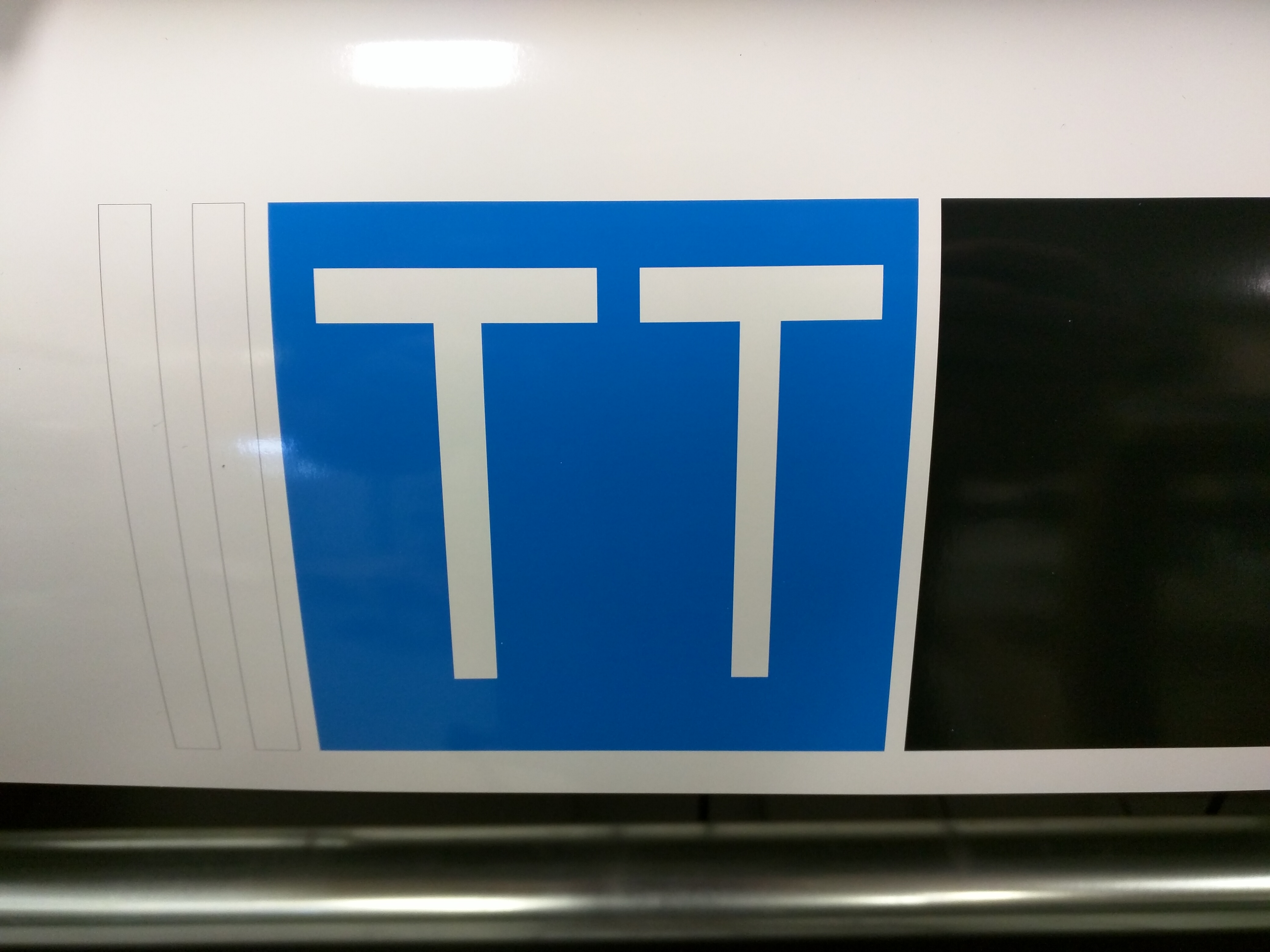

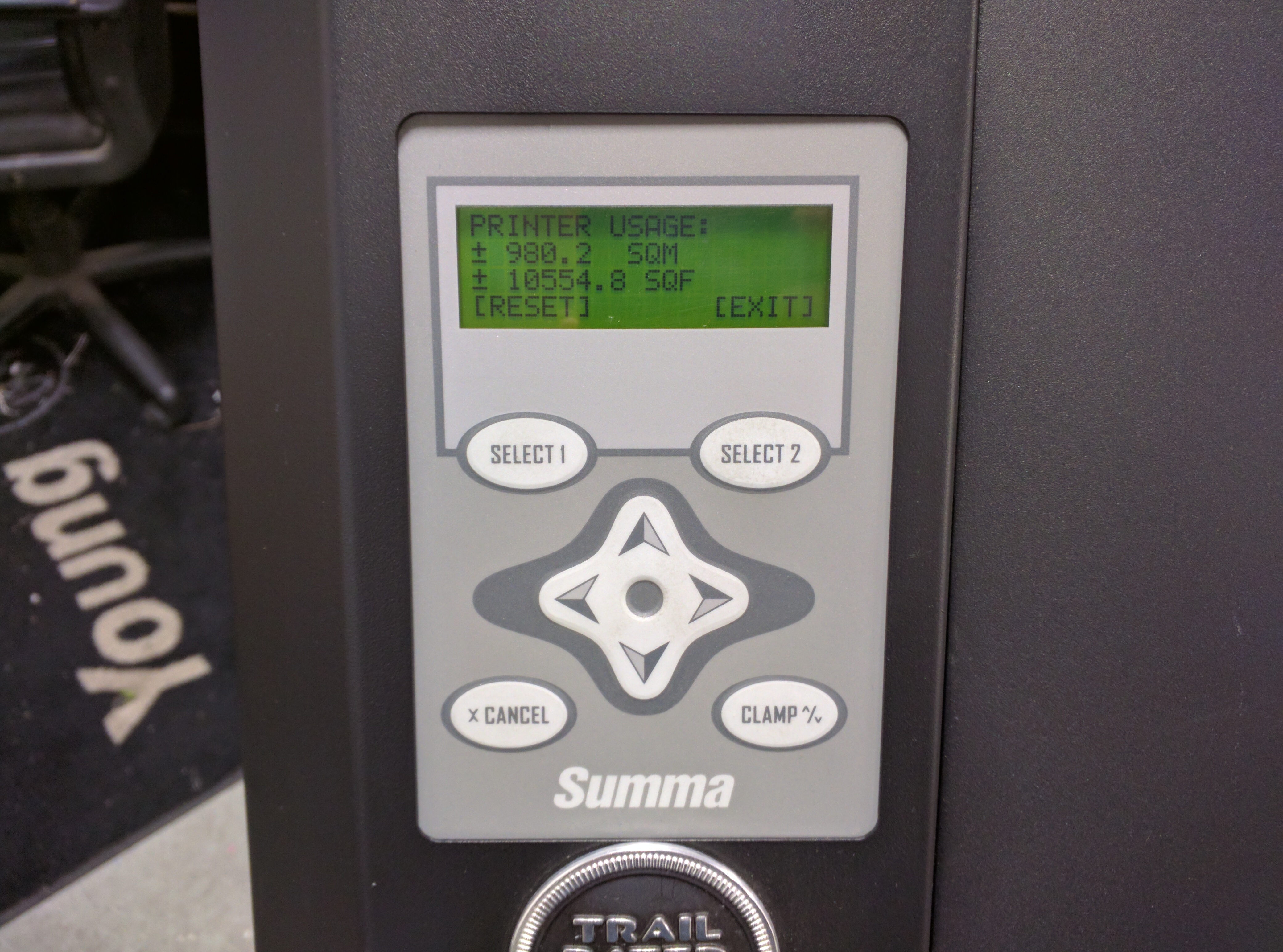

    As to what to look for, ask for total printer usage (see image) and ask for a solid color test print; it doesn't matter what color the print is since it only has 1 printhead (see image). If I remember correctly the printhead has 1024 individual heating elements that heat up the resin and transfer it to the substrate, so if you look closely and you see a blank spot that goes the entire width of the print then it has a bad spot. If I remember correctly a new printhead is about $2,500 but fairly easy to replace.

    Thank you XtremeXccessories for the reply and information! What is a lot as far as total usage goes? I see you are over 10,000 sq feet. What life can be expected out of the print head, etc.?

    Honestly I'm not sure what the life expectancy is on the printheads. We had to replace ours because it was damage from material contamination. Which reminds me, make sure it also has the OptiPrint cleaning system (or you get a new one if you purchase). It's a sticky roller that is mounted to the side of the printhead carriage and cleans contaminates ahead of the printhead. If it doesn't have it or it needs to be replaced that will add another $300 - 400 to the price for everything.
