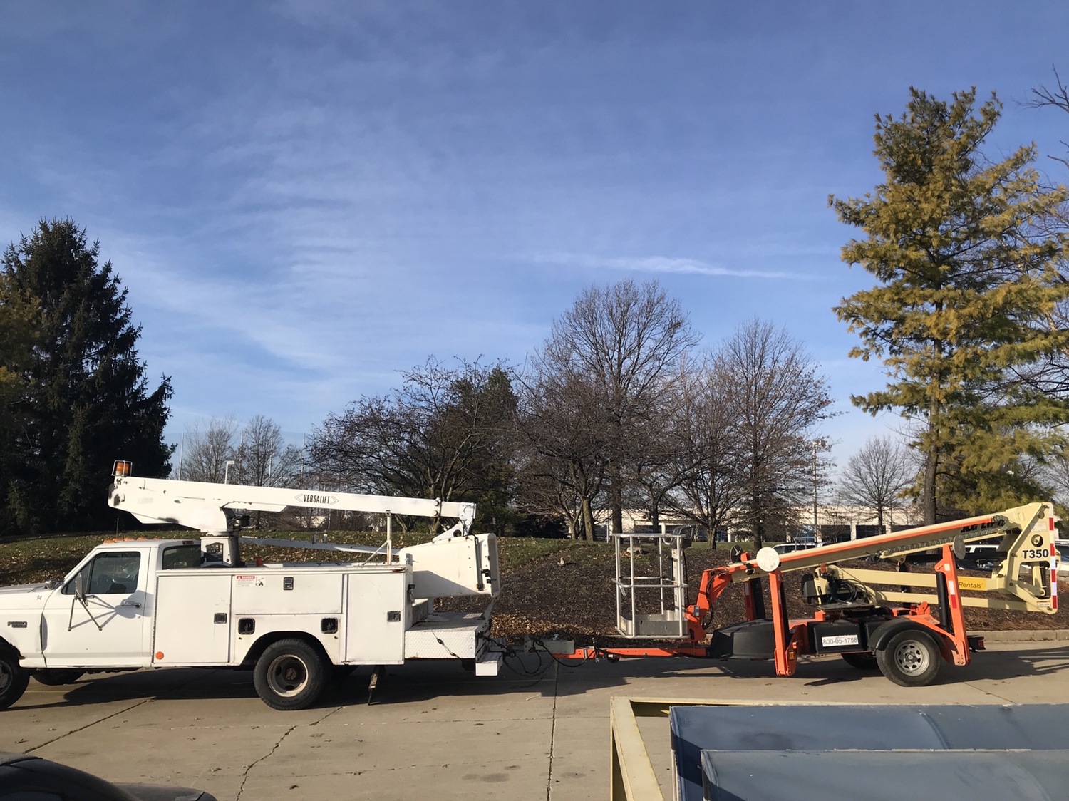

I am a wholesale printer who became friends with one of the local sign shops. He knew that I had done a lot of construction work on the past and has a lot of tools and started asking me to help him out with service and install work as I was growing my printing business. On an occasion last February, he asked me about pulling some channel letters off of a building and reinstalling them on another building. I did the job with him on a ladder to pull the letters and then used a Small rickety scaffold to put up the letters. The job ended up taking two days because I also had to deal with a brick install and only had a $60 hammer drill and tap cons. After that job, I noted how much faster it would be to have a bucket truck with the right tools. I found a 1995 Ford F-350 with a 29’ boom (hits about 36’ straight up hit most jobs are at an angle).
I only paid $4750 for the truck and the insurance is about $550 per year. I spend 1-2 days a week in it. The floor board is all rusted out and so are the bottoms in the tool box but the truck paid for itself in 3 months. I just did an install last Thursday for $250 that was 3 miles from my house and took me about an hour and a half from the time I left the driveway to the time I got back home. I do wish I had one of the nice articulating booms with material handler and at least 42’ height but this truck is getting me paid. I had a job back in December that I couldn’t do with the truck so I rented a towable loft. I knew I could’ve get the truck in a position to use it so I charged the client for the rental on top of the install fee. The speed and convenience of the truck are fantastic. I now do all the installs for a a local franchise and a few other local shops and it’s all been from talking to them when doing their printing.
I am a very cautious person and after 14 years as an officer, I often fear taking risks that can be avoided but I am now taking a leap in my printing business as well by adding a Scitex FB500 to run flatbed work. Found a great deal on a used one that has been taken care of. Wish I had done this sooner as well. My math showed that my material costs and time costs compared with print/laminate/mount are going to astronomically better.
Having a truck or any tool is just as much about being more efficient and saving money as it is about generating additional revenue.
I attached a pic of my “rig” from when I rented the towable lift as well. This truck isn’t pretty but it makes $$$. I’m about to hire someone to work just the install/service as it’s growing quickly as a subcontractor for the other shops in the area.
