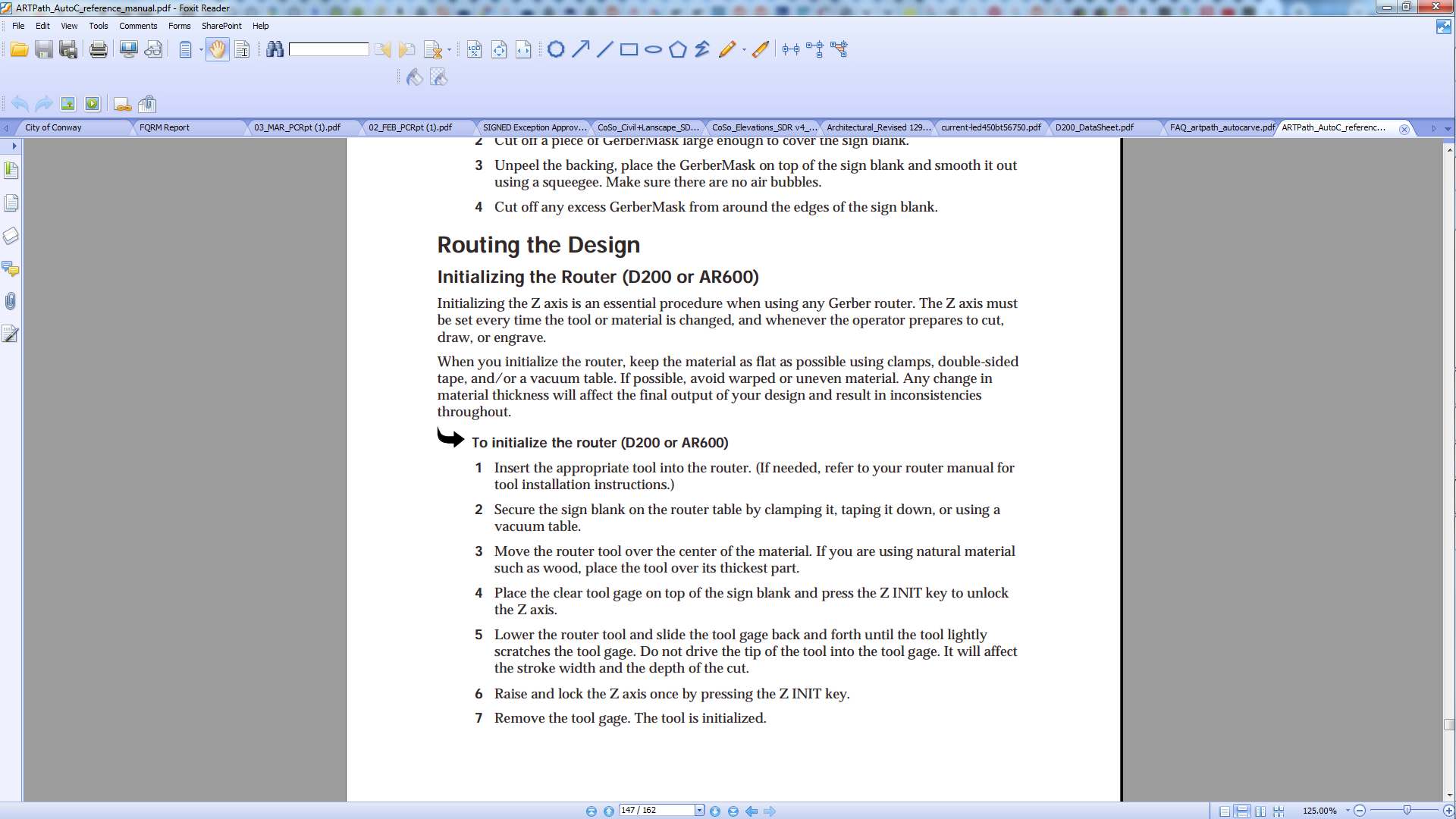

Also, I did try and run files to this from ArtPath, using a cable from the 'control pad' box to a laptop, and could not figure out how to 'route' what I had on this file to test it. I got to the point in ArtPath where I go to the 'output' menu and send the file to the machine, but couldn't find out how to get this to 'route' or cut the design - I am thinking I am missing a step from the control pad.
